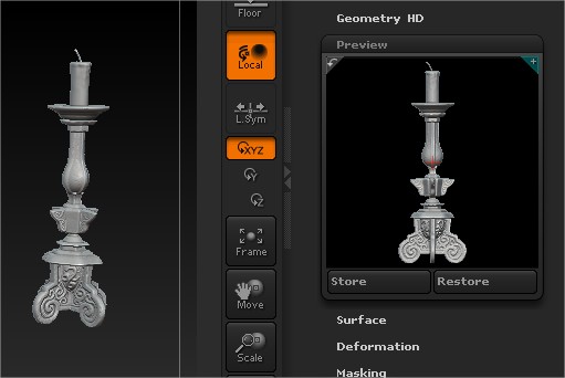

Working with ZbrushR6 and Max 2014, I just want my sculpt to relate to correct cm units in max. As you can see here, looks ok in Zbrush. To scale in preview window etc

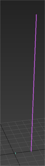

If I export/goz to max it’s super tiny (purple shape is human height, 160cm)

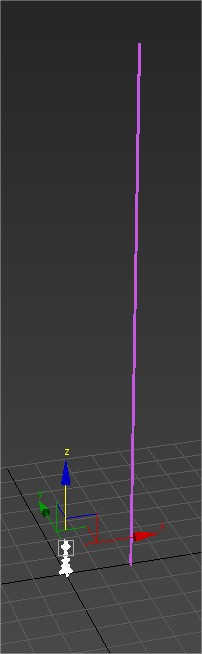

I check to see how much scaling is required to make it correct. It’s x3000

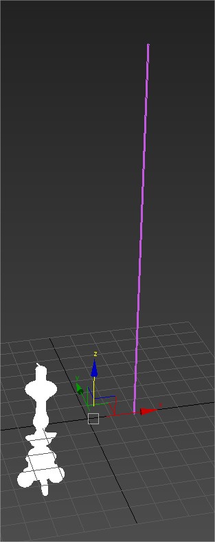

So in Zbrush I scale a subtool x 3000 and repeat to others. Export/goz but now it’s smaller than what the same scaling did in max.
So I think, ok, will export this 5 times bigger using these settings. Ends up SMALLER :confused:

Aha, found a fix! I still don’t get my subtools but I could if I wanted to (current ztool is 20 subtools so it would have taken about 30mins). Anyway, this is how you do it.
  • Drop in a box with human height (160cm) and adjust the wrongly sized exported ztool in relation to the ‘human’. In my case, the piece needed to be x4 bigger than it was. I noted this down.
  • In zbrush I resized one of the subtools x4 (you have to type in 100, x4, can’t do it in one go) and then repeated to others (with a click of just one button)
  • Now your subtool is the correct size, I merged each subtool into one and did a GOZ to check and sure enough it was now the correct size.
So, it’s destructive but at least it works for when you’re sure that you’ve finished with your sculpt. Just know that you can’t go back unless you’re prepared to repeat the process.
