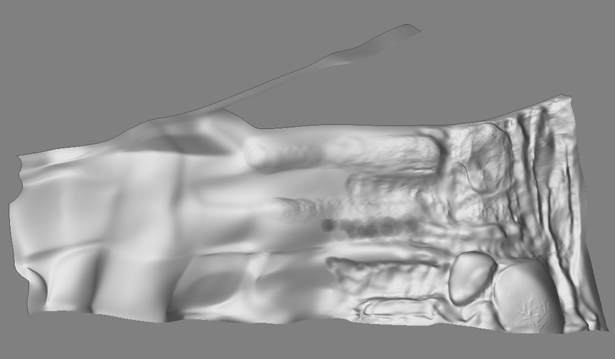

OK perhaps this scan help, I used your supplied image, and a simple plane as polymesh. After this script runs, you can subdivide and do more deatil following the same procedures. Then you paint with textures for real detail, see the video on Zbrush site (they paint a person). The script will ask you for the image - last one.
you rock! (no pun intended) Great method for working!! very cool stuff to start in zbrush. Going to give’r a try now. Thanks again:D
