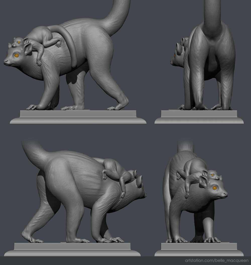

I am struggling with sculpting fur and would love some pointers!
