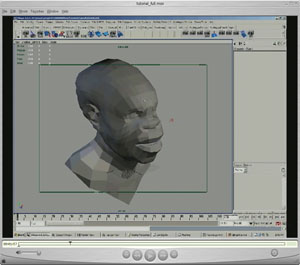

I made a quick video walkthru on rendering the Pixolator test head in Mental Ray. It is a rundown on the settings I use to get good renders and I hope it might help some others in the community.
It isnt the end all of approaches but what I found works well and helped get me started with using Zbrush and Maya together.
Download here
The movies are quicktime and compressed in zip archives
LARGE 26 MEG QT
MEDIUM 18 MEG QT
SMALL 6 MEG QT
screen.jpg [Icon200.jpg[/attach]]]([attach=11026)
