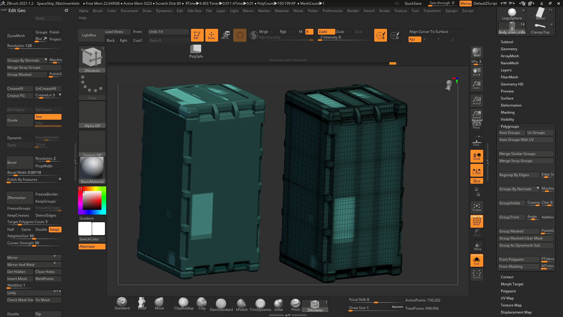

I am running continuously in the problem of getting random masks on my subtools. No matter how I create the mask, spots are missed, even though the subtool has one solid polygroup . When I clear the mask and create a new one again I get random spots , this time on other parts of the mesh. The attached screenshot shows the seemingly perfect polygroup, with a mask applied ( Mask polygroup all ) .
The same effect happens with all the ZModeler Brushe’s masking tools. The only way to get a correct mask is to Ctrl -drag rectangle or lasso.

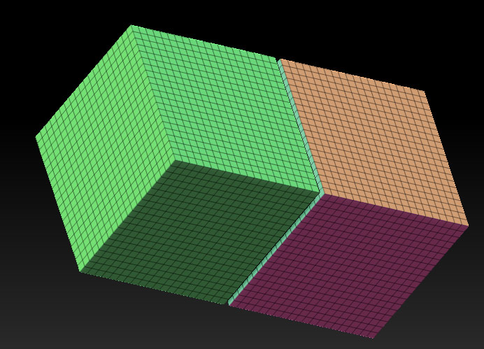

Confusing! But it could make sense if you happened to ZRemesh with the “Keep Groups” function enabled, and ZRemesher happened to assign overly similar polygroups to adjacent areas. I got such a result very quickly with ZRemesher ( perhaps too easily ). In the following image I ZRemeshed a couple cubes with Keep Groups active, and while each side of the cubes are a different polygroup, it assigned colors so similar to one of the cubes it appears to be the same polygroup:
polygroups
