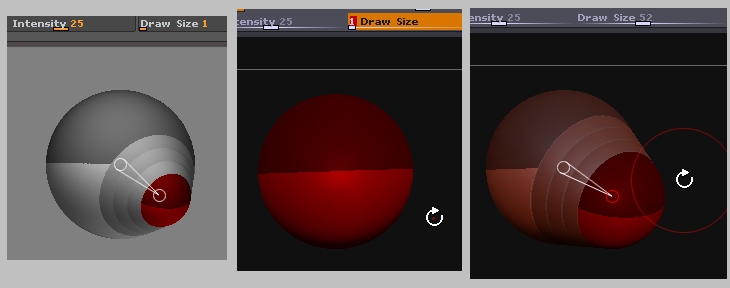

No … the issue is that the draw size updates after you’ve drawn a zsphere to the size of the sphere you just added. If you’re used to drawing with size 1 selected, this means you have to keep altering the brush size. Not a major issue if you’re working with similar sized zspheres, but a pain if drawing lots of varying sizes. Comparison between ZB2 and 3 below. After drawing a sphere in 2, the brush size stays at the originally selected size. In 3 it updates.
[attach=57300]zsphere_size.jpg[/attach]

Thanks for explaining but I still can’t see the problem - unless ZSpheres in ZB3 are behaving differently for you than me. If I am drawing a new zsphere I click and drag to adjust the size, I don’t need to worry about the brush size at all as it has no effect.
On zbrush 2 it was recommended that when drawing zspheres the brush size stay a constant 1, does this mean this is no longer a problem? I mean it was known to cause problems back then.
Yes, it is no longer a problem. :slight_smile: Also, zspheres are rather better in ZBrush 3. :slight_smile: For example: if you draw a zsphere, drag to the size you want, then hold down Ctrl, you will be able to drag the new zsphere away from the previous one - you are in Move mode. Click Ctrl again and you will be able to Scale. Click again and you’ll be able to Rotate.
Thanks that explains it all
It’s not when drawing a sphere that the brush size matters, it’s when moving spheres. When switching to draw mode and back to move mode, the brush size changes and that’s where the problem is. I usually want to move only one ZSphere or ZSphere chain at a time, so I want the brush size to always be 1 when I’m editing ZSpheres. That’s the way it behaved in ZBrush 2, but not in 3.

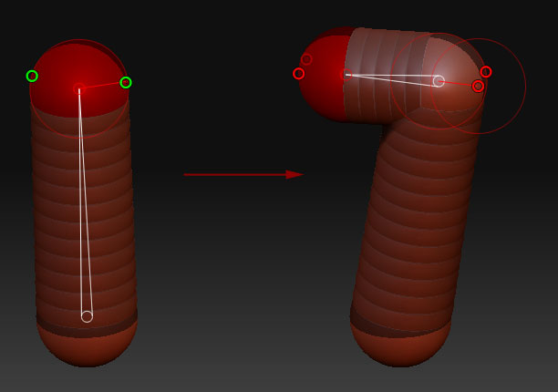

I’m also having a problem with drawing symmetry. When I try to create with symmetry, it causes unusual behavior, creating a zsphere on only one side like the pic I’ve attached.
You can also see that drawing out the new zspheres resized my draw size, which may or may not be causing the problem.
Ah, the symmetry problem seems to be when I have more than one axis drawing symmetry at the same time (Z and X in the picture last post). I never had such a problem in Z2.

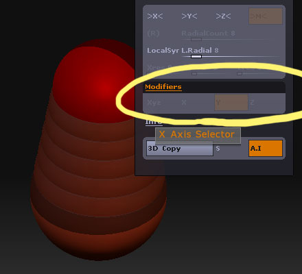

Another problem: :confused:
I can’t access the Transform modifiers with zspheres anymore. They still seem to apply if I change them with another tool beforehand but I can’t changed them while editing zspheres.

Yes Marsyas ur right! Settings in the xyz-Modifiers (-the locking of the X Coord.f.eg. ) also seem not to have an effect on Polymeshes when doing some transpose technique like scaling or so…:confused:
