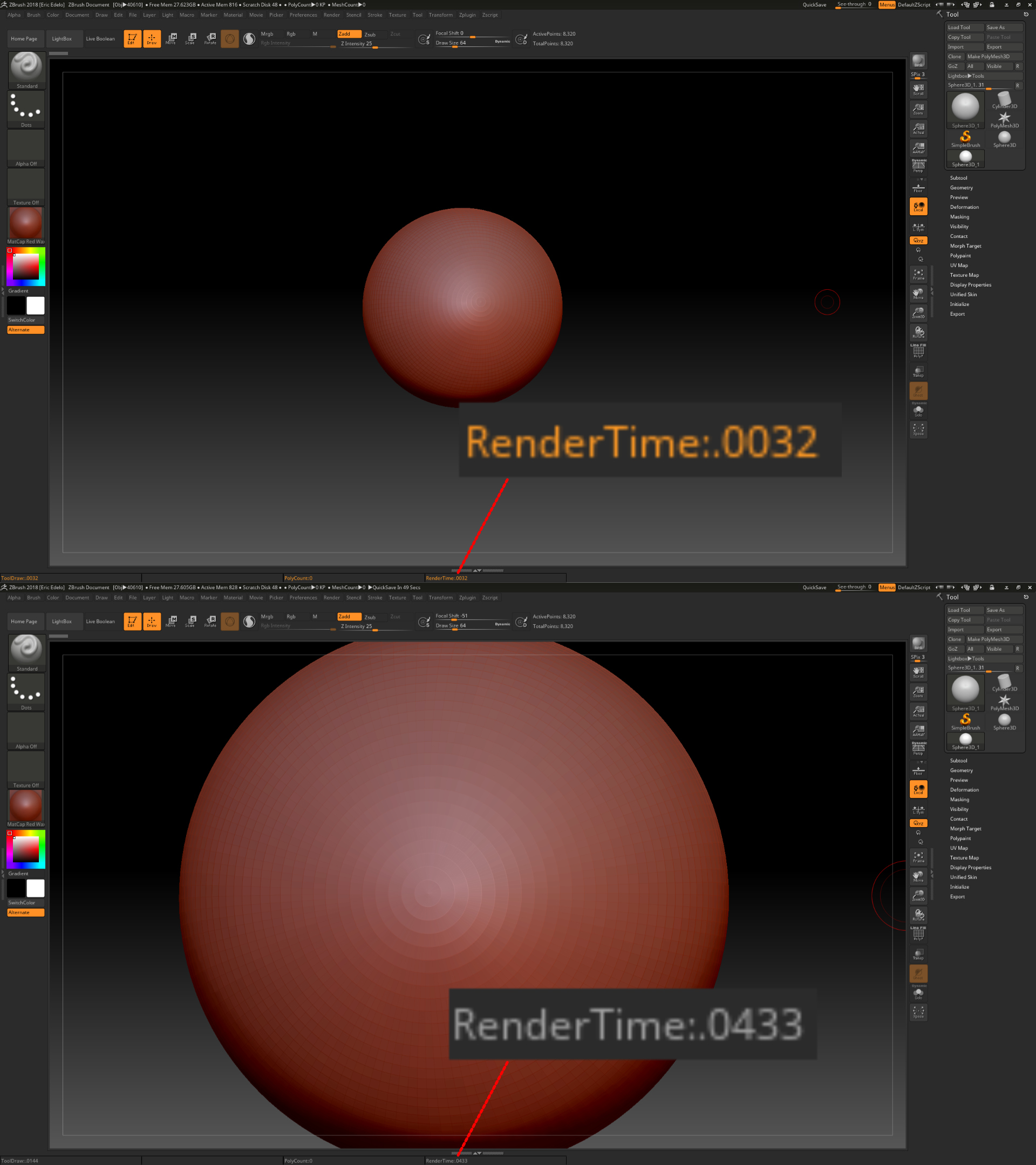

Here’s a screenshort of the viewport, comparing how the area the model is coverage is influencing the rendertime/framerate found in “Preferences > Utilities > Timing Info”:

I have the same experience.
4R8 was faster and more fluid overall.
Sadly that’s true.
Even though I really like sculptris, I might go back to 4R8, because I miss the more fluid performance.
Do we have any official info regarding this regression? Maybe it can be improved in future versions.
