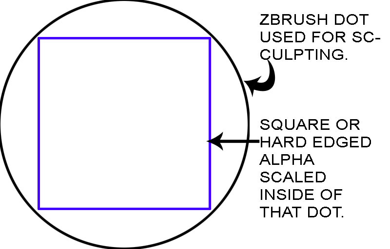

One trick is to shrink your square alpha inside of the circle that zbrush uses for brushes and set focal shift to -100. That will give you a hard edge.

Inside of Photoshop or some other image editor you can simply make the square or hard edged alpha you want to use smaller so that it fits in the circle that ZBrush automatically uses for sculpting.

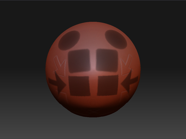

Lemmo, do you mean you still get the edges of the square cut off? I think your square is not small enough. Did you try that alpha I made that I uploaded in this thread? Wait, there’s only one m in lemmonado and two n… LOL :smiley: just realized that. Everyone seems to love to write your name with two mms :stuck_out_tongue:
Perhaps the reason behind the circle mask for brushes is because the pointer we’re using is circle shaped (that red circle around the pointer) so that the mask would fit entirely within that circle. Am I right?
It should make clean square masks. (that's the square alpha on the bottom)

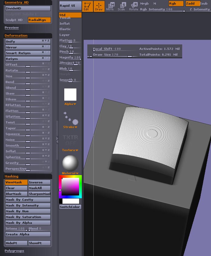

This looks like the right thread?
Two questions. The first I think is what Lemo was asking, not sure.
I create a square alpha in PS. 16 bit. No anti-aliasing so perfect edges. Small enough to fit inside the circle. Pure white on black.

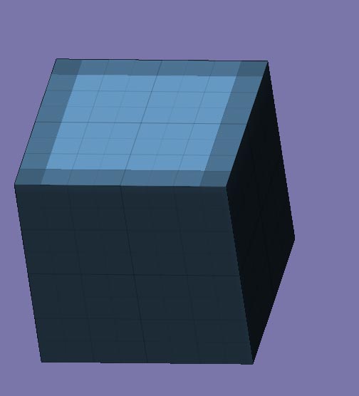

I then started with a 6 poly cube and UV Tile. Divided to about 1.5 million poly and then HD to 6 to make sure there is enough poly’s to get a smooth edge. Then I use Deformation Offset to try and pull out a flat surface.
I end up with what you see below. When I applied the mask using the alpha I could visibly see the dithering even though it was a 16 bit alpha with no focal shift and no anti-aliasing when it was created. I’m not posting a shot of the visible dithering because it is only visible on a high contrast monitor. You can also see the little triangle thingy (technical term :rolleyes: ) that pops up.
Now you could say just use the smooth brush but - The smooth brush does not give clean edges on the five raised sides that I’m trying to get.
I Ctrl>Shift Drag to hide the one side. I then Ctrl Drag and release Ctrl to get a solid mask over the remaining 5 sides of the cube. Then I Ctrl>Shift and click in the document to unhide the hidden side. I get what you see above 100% of the time at any poly count. This is also true of any other mesh I try but I thought it would be easier to show with a cube. Getting clean edges when I mask unhidden poly’s while others are hidden does not appear to be possible.
Any help with this???

Hello Blaine91555,
For your second image, the issue at hand is that we are masking verticies, not polygon faces. Each vertice can have only one masking value.
For example, the vertices at the corner of the cube are shared between the polygon faces around them. Depending on which vertice it can include the top, side and front. This is why your masking appears to bleed over the edges. It is still a hard edged mask but the vertice you have masked is shared between multiple faces.
For your first image, I would suggest using tranpose to get exact movements of the polygon faces as opposed to the brush. You can also use the flatten brush with its elevation setting for a loose but more uniform positioning.
If you have a more real-world example of what you are trying to do and unable to do please post the images and I’ll check it out.
