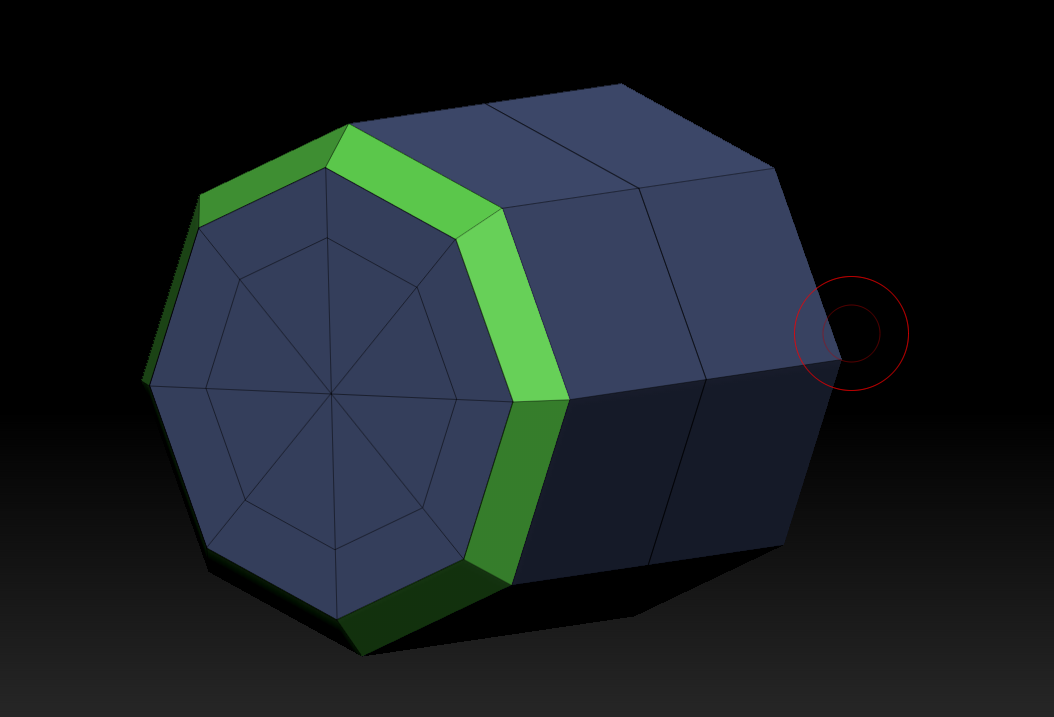

It asks to "add an extra edge loop to the middle of the cylinder (step B), dynamesh, and delete lower to achieve picture C.
I cannot for the life of me figure out where they want me to add the edge loop in the “center” Every place I have tried gives me a completely different end result than required.

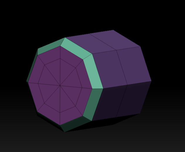

This is my current version, the front also didnt create another polygroup that is implied in the picture when I beveled the edge.
Any help would be greatly appreciated.
solved the polygroup problem, still missing the added center edge loop piece…

I’m not clear on exactly where you want to add the edge loop. It looks like the extra geometry in Image C comes from the mesh having been subdivided .
However, the simplest way to add an edge someplace with Zmodeler is typically with ZModeler> Edge> Insert. Setting the target to Edge Loop will insert a single edge loop running perpendicular to the clicked edge. If you set the action to “Multiple Edge Loops” it will let you space out a series of edge loops at regular intervals.
I can’t account for what you might be reading, but the fastest way to get from the cylinder in image B to the Cylinder in image C is to subdivide it once, then use the Edge> Insert function to delete a couple extra edge rings on the cylinder endcaps by Alt-clicking on them.
