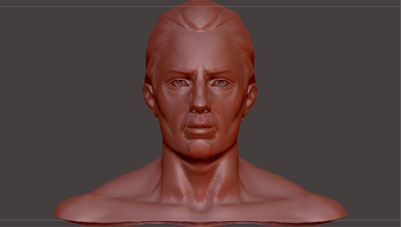

EXHIBIT A …
[IButton,“mButton”,“myButton”,
[TransformSet,0,0,0,0,0,0,0,0,0]
[IPress,Transform:Fit]
…gives this result…
[TransformSet,0,0,0,0,0,0,0,89,0]
…gives this result …

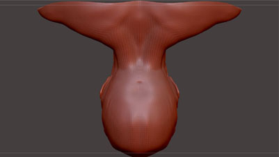

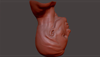

So far so good, but here is where I get confused …
[TransformSet,0,0,0,0,0,0,0,90,0]
…gives this result…
…and…
[TransformSet,0,0,0,0,0,0,0,180,0]
…gives this result…
Question 1: Why does any Y rotational value over 90 flip the model upside down?
