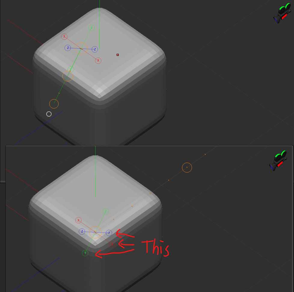

Question: Is there way to reset the rotation and posion of gizmo?
I would like to record the button above gizmo, but I could’t.
Is there way to world-reset the rotation and posion of gizmo by script?

This is what I can’t understand.
[TransposeSet,0,0,0,
0,0,0.25,
0.25,
1,0,0,
0,-1,0,
0,0,1]
//the value from world resetted gizmo
When you have a already moved transposeline somewhere, and run this code,
XYZ of transpoose-line rotate every time.
“of red(blue, green) axis” , is vector or something?

Thank you, your script does not rotate every time, however, it can’t reset “this (below)”. (if the transpose-line has already some rotated axis)
and, I want reset “this (below)”.
My stacked point is it.
when I set the static value to “xyz of red(blue, grenn) axis”, the XYZ line is rotated every time every run, despite of static value.
