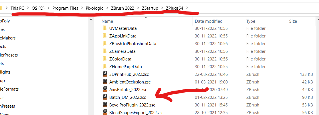

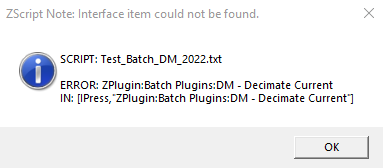

Before I attempted spending many an hour trying to get this working.
I have a lidar set model from Reality Capture cut up into multiple subtools. Which I then need to export Levels Of Detail into a HighRes MedRes and LowRes obj.
Is it possible to once the subtools are ready to have a zscript that will pre-process all subtools(decimation master). Then export the subtool with _HR on the end, decimate 10%, export with _MR, decimate 2%, export _LR. Then move onto the next subtool until they are all done? No UV’s or textures are required just raw mesh.
I have seen zscripts to export subtools with their naming. But was it possible to add the decimation master component into it?
Thanks for your time.
