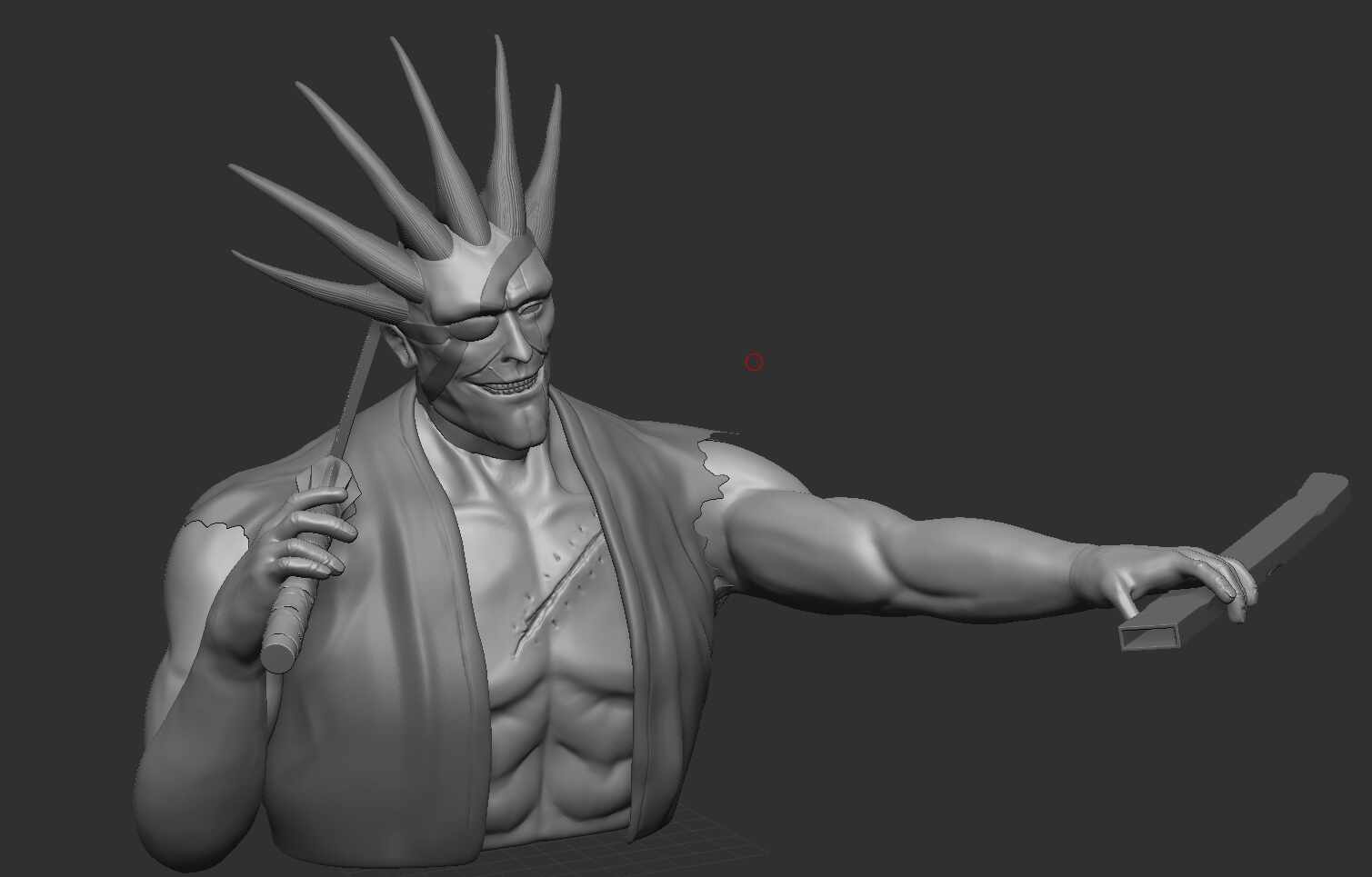

Hello, guys! I just finished my model and I want to learn how to do retopology, however, after watching a lot of videos, I had a question, it’s correct that I already posed the model? After all, now I can’t use symmetry during retopology in Maya. And if I do a retopology first, and only then pose a low-poly sculpt, will I have to separately pose a high-poly to bake properly?
I’m a little confused about the sequence and how to do it right. I would be very grateful for help :slight_smile:
