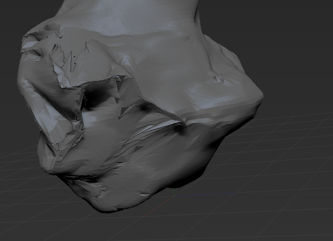

When I click on DynaMesh it asked me to “Freeze SubDivision Levels” and so I did, then DynaMeshed it and unclicked “Freeze SubDivision Levels” and this weird sharp things just came out (Can anyone please help me):
http://prntscr.com/5n4qgm

If you try to dynamesh an object with multiple subdivision levels, it will give you the option of “freezing subdivision”, which is an automated form of the subtool projection process where detail is projected from the original mesh onto the new, multi level tool. As to why you are experiencing projection errors I can’t say. Something may be problematic with your tool, or the projection settings in the subtool palette may need to be adjusted…most often the “Dist” slider.
If you’re dynameshing frequently and would like to simplify this process, it is recommended you delete your lower levels of subdivision during the dynamesh stage and only work at a single level of subdivision. Dynamesh works best for objects of medium to medium-high poly density.

As I said, if you are dynameshing frequently or using insert brushes, it’s recommended to work with a mesh with no subdivision levels. Delete any lower levels before remeshing. Otherwise it has to initiate this process. Dynamesh does not support multiple subd levels.
Use dynamesh and insert brushes to quickly establish form, then use zremesher afterward to establish a new low poly mesh with clean topology, subdivide that, and project the detail from the original mesh onto it. Then you have a new object with multiple subd levels and good topology ready for a traditional multiple subd workflow. Any dynameshing should be infrequent, if at all, after that point.
Thank you! Deleting lower division made life easier!
