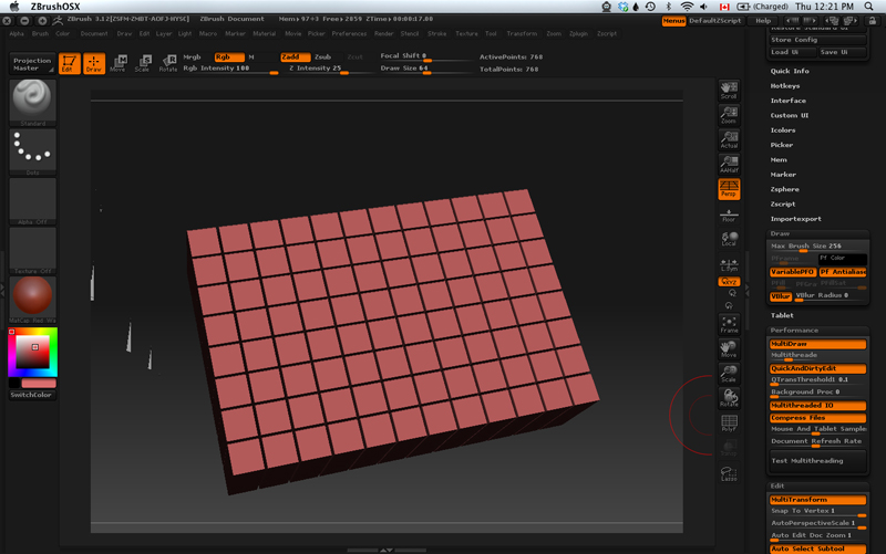

I check the initial Zbrush brush active unit is based on vertex, you draw on the surface basically pull or push the vertex in or out. But I have a question now requiring brush to active on the faces,(imagine you drew on one side of a cube with lowest subdivision, and I want to drag the face on that side out of the cube) like you do extrude faces in Max or Maya. but you use brush to control the value.
I was wondering if any scripts or plug-ins would help to achieve this effects. Screen shot 2010-01-14 at 12.21.07 PM.jpg

the model is actually way bigger than the image I upload, so it’s quite frustrated to manually modify it in Max or Maya, plus I want have a randomness but controllable hight value on the extrude. Like if I wanna do a patten based on this Grid model.

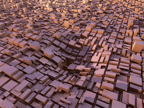

i see, well there is a great free plugin for max called greeble, you should definitely check it out :wink: as far as zbrush, I don’t think that there’s an easy way unless you apply a checker texture to this model, them mask by intensity and then pull out poly’s, but i’d go with greeble, way quicker and hussle-free
here’s an example of what this plugin does in the image below
[[attach=175699]1227553805_greeble.jpg[/attach]](javascript:zb_insimg(‘175699’,‘1227553805_greeble.jpg’,1,0))
Thanks for your help, Skarpunin, I am going to try greeble :smiley:
