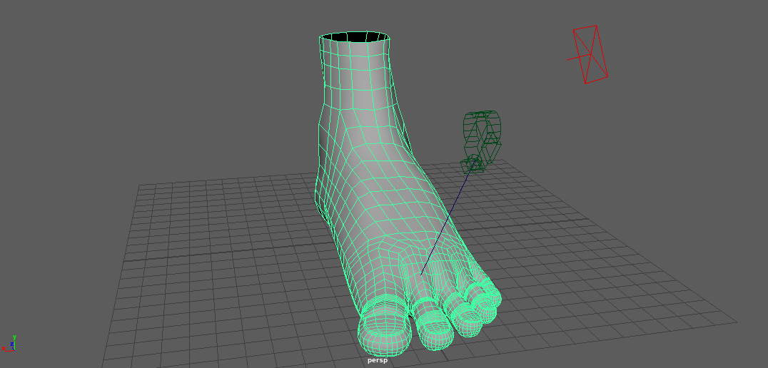

i have sculpted a mesh in zbrush built in maya, them i retopologized the sculpt on in 3dcoat, now i import the retopologized mesh in zbrush and i cannot project the details over that retopology.
both has diferent topology.1 2
im thinking that the topology are too different to project the details.
any thoughts, tks in advanced

tks for the answer, the first pic is the mesh that i ve sculpted on zbrush, coming from maya.
this is the mesh that i ve sculpted on zbrush
1a

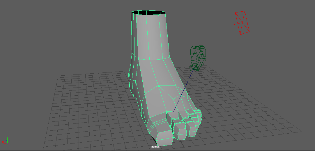

later i ve exported a mesh sculpted from zbrush to make the retolopology in 3dcoat.
this is the retopology that i ve made on 3dcoat.
2a
i think that could be the retopology.
