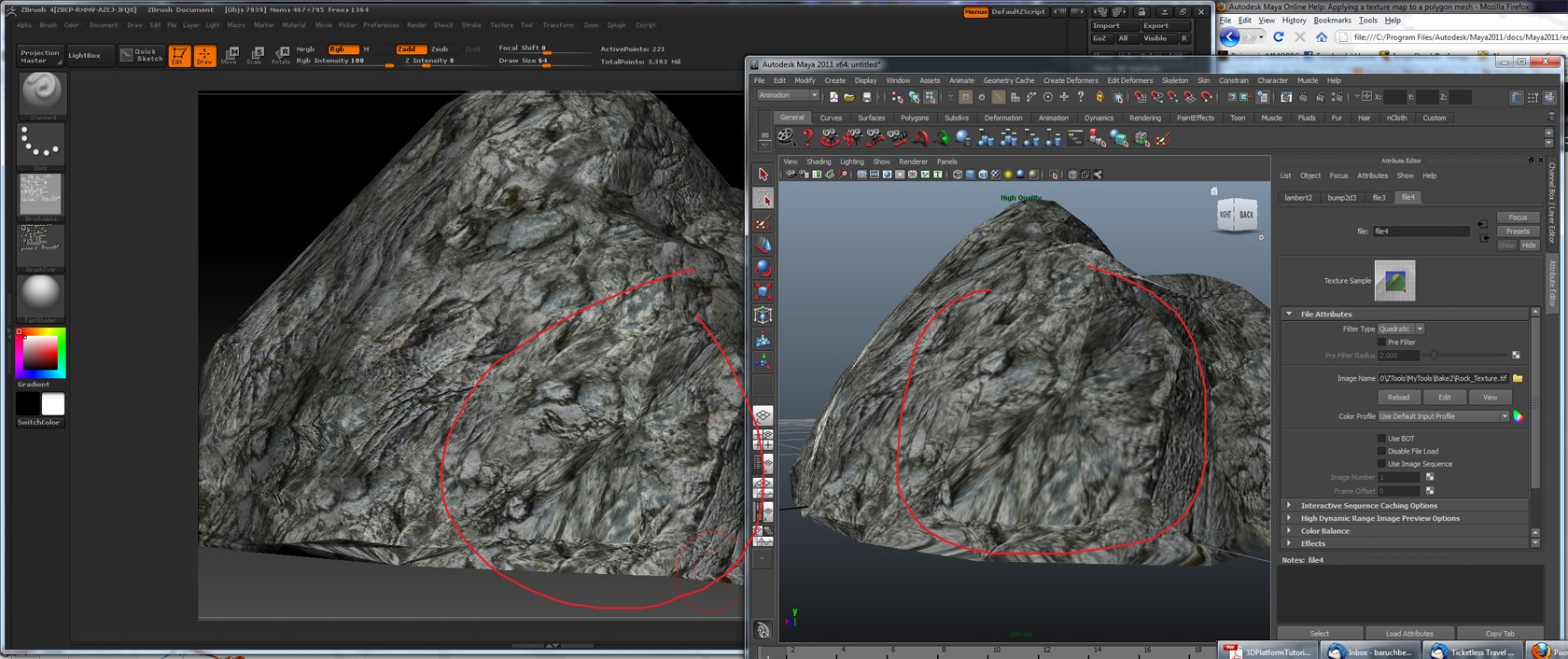

Hello all,
[Rock.jpg[/ATT]%3C/font%3E"]
](http://%3Cfont%20color=%22#9A9A9A%22%3ETT=235428)Hello all,

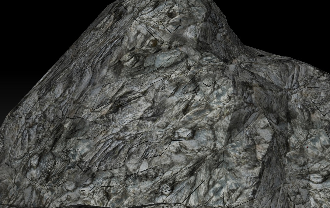

](http://%3Cfont%20color=%22#9A9A9A%22%3ETT=235428)This looks like polygon stretching at that particular area. You might want to try different UV mapping such as PUVTiles.
@aurick Aha, that definitely helped! Thanks for the tip–and fast too
. I’ll have to read more into PUV vs GUV, etc.
Output:
Again, thank you very much for your help. It is very appreciated. Once I can get this workflow going I will definitely be using ZBrush in all of my modeling.
