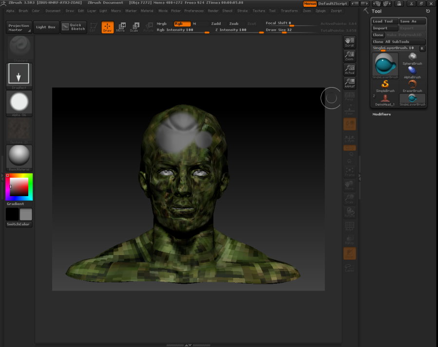

maybe it much easier to see a screenshot of your problem.
Here is the screenshot.
As you can see, I have set a UV map, and applied a texture map to the model. I then selected a texture from the left dock, and dropped into Projection Master. At this point the texture box becomes disabled, and I find that I can only texture with the current color.
So, my question is : how do texture while in Projection Master ?
As goast666 posted earlier: Tool/Texture map and select the texture you want to use by clicking on the (still) empty icon and selecting the texture you want to use.
No that does not work, because the Texture Map sub-palette is no longer available once you go into Projection Master.
if you switch to the simplebrush in tool palette you can use a texture from the texture menu (not the tool texture menu)
spaceboy, that does not work either. True that it enables the texture palette, however when you choose the texture, it paints on to the canvas, not the model (I am talking about when you are in Projection Master mode).

Here are my steps:
(1) Load up DemoHead;
(2) Put in Edit mode (if not already);
(3) Change material from Red Wax to Basic Material;
(4) Go to lowest sub-division level;
(4) Apply UV Map - Packed UV Tiles with Map Size of 2048;
(5) Bump sub-division levels back up;
(6) Click on Tool>Texture Map and select Texture 25;
(7) Click Texture On button (applies the texture at this point);
(8) Click Projection Master button;
(9) Accept defaults, i.e. only Colors and Fade checked and click “Drop Now” (note: at this point, it appears to drop out of Edit mode, as the Edit button is no longer highlighted);
(10) Select Simple Brush from Tool palette;
(11) Select Texture 21 from Texture palette;
(12) Start painting - at this point it paints on the canvas, not on the model.
I note that when you go into Projection Master, it defaults to the Single Layer brush. This continues to paint on the model. But as soon as you select the Simple brush, it paints on the canvas.
So, this seems to mean that you get access to the Texture menu at the expense of being able to paint on the model.

heres a really quick video
http://www.youtube.com/watch?v=GX3rDiT9bwk
jason uses the directional brush in his vid and i did here as well
Ah, the directional brush. The missing link. Just goes to show that you have to be careful to observe every detail of a zBrush workflow.
I don’t know how many times I watched this tutorial, but missed the bit about the directional brush.
Thanks, spaceboy412.
