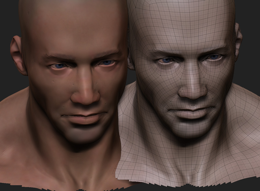

hi, i always used the “project all” button to reproject details and colors from one subtool to another without problems. but in this model i noticed the follwoing problem: every “star” (five edged vertice) in the model is pinched and i cannot remove it at all using smooth. I’m using clay and flatten brushes as a workaround, but i dont like the look of it.
I just imported the retopology model and reprojected the deails. The original model was smooth in this areas…
any ideas?

oh yes, the problem only happenend in the head… a lot of other five edged vertices in the body are ok…

As far as i know Flatten works best, but i agree its not ideal. Smoothing only makes it worse. You could try to use the Move brush with a draw size of 1 and move those points out manually.
