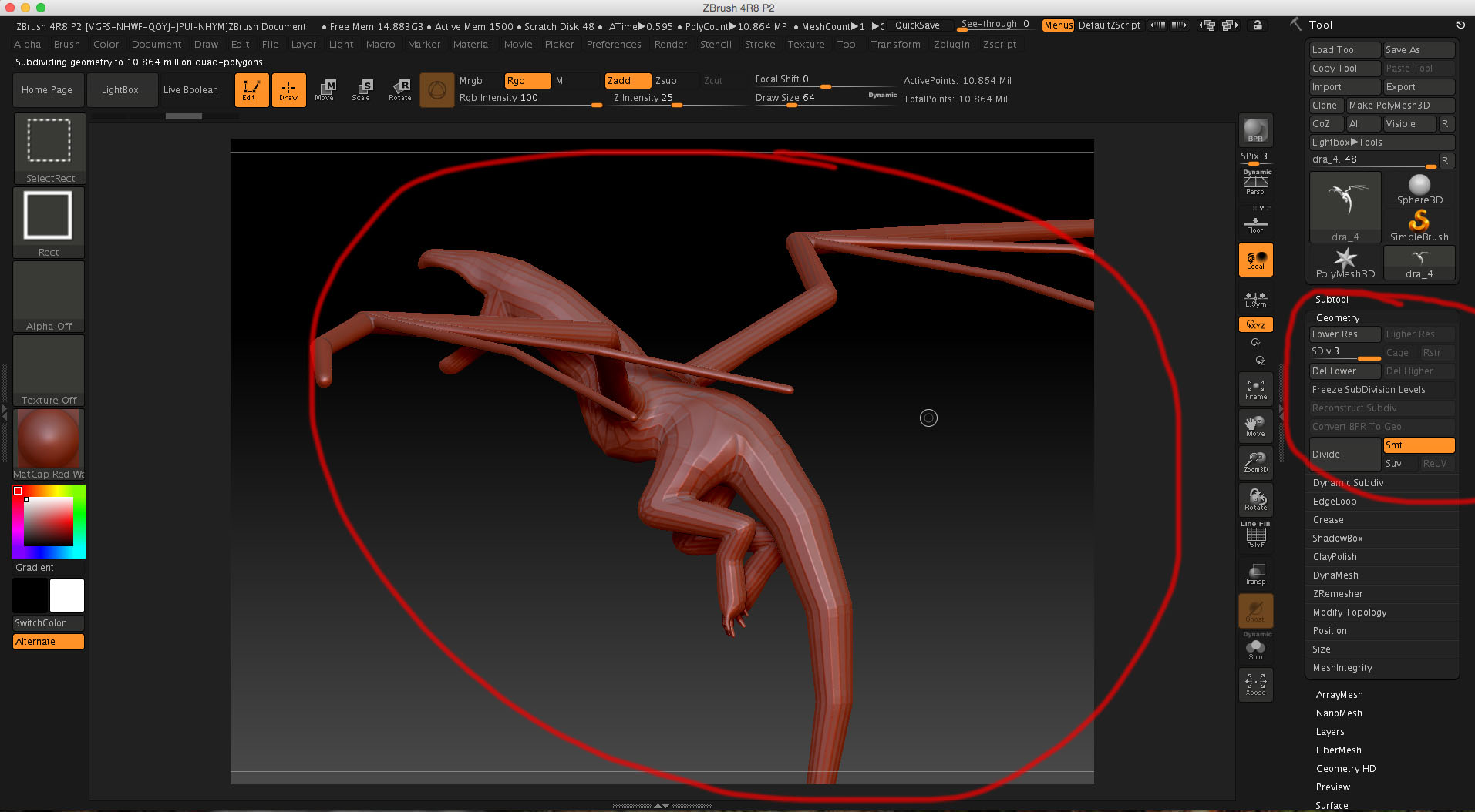

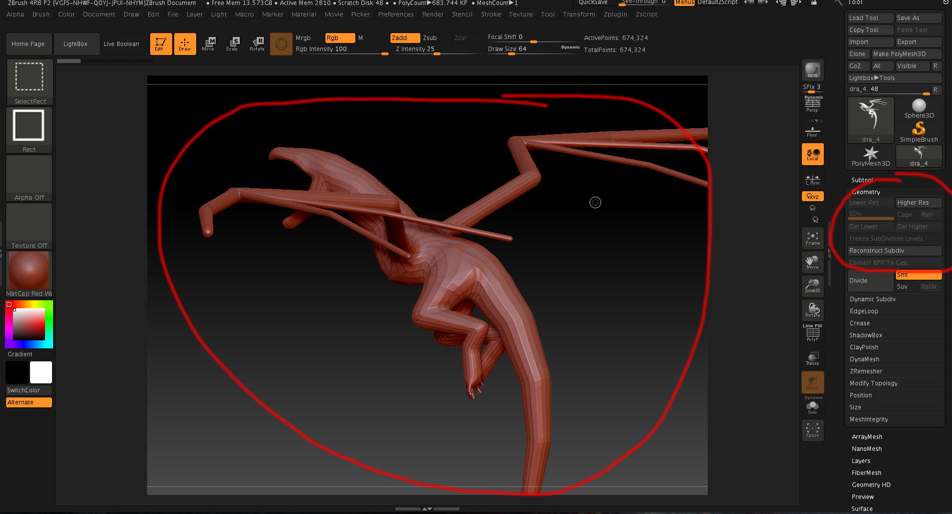

Can someone please help me with a problem. After i converted a model from zsphere to “Make Polymesh 3D” and I try to increased the subdivision, but even if i clicked the Divide a few times the object still has the same resolution it doesn’t smooth it out. I’m using brush 4r8 p2.

Thanks, I tried it but still doesn’t work.
That’s because the Adaptive Skin you made is Dynameshed. With your ZSphere tool selected, turn “DynaMesh Resolution” slider in Adaptive Skin subpalette down to 0 before you click “Make Adaptive Skin” or “Make Polymesh 3D” button.
