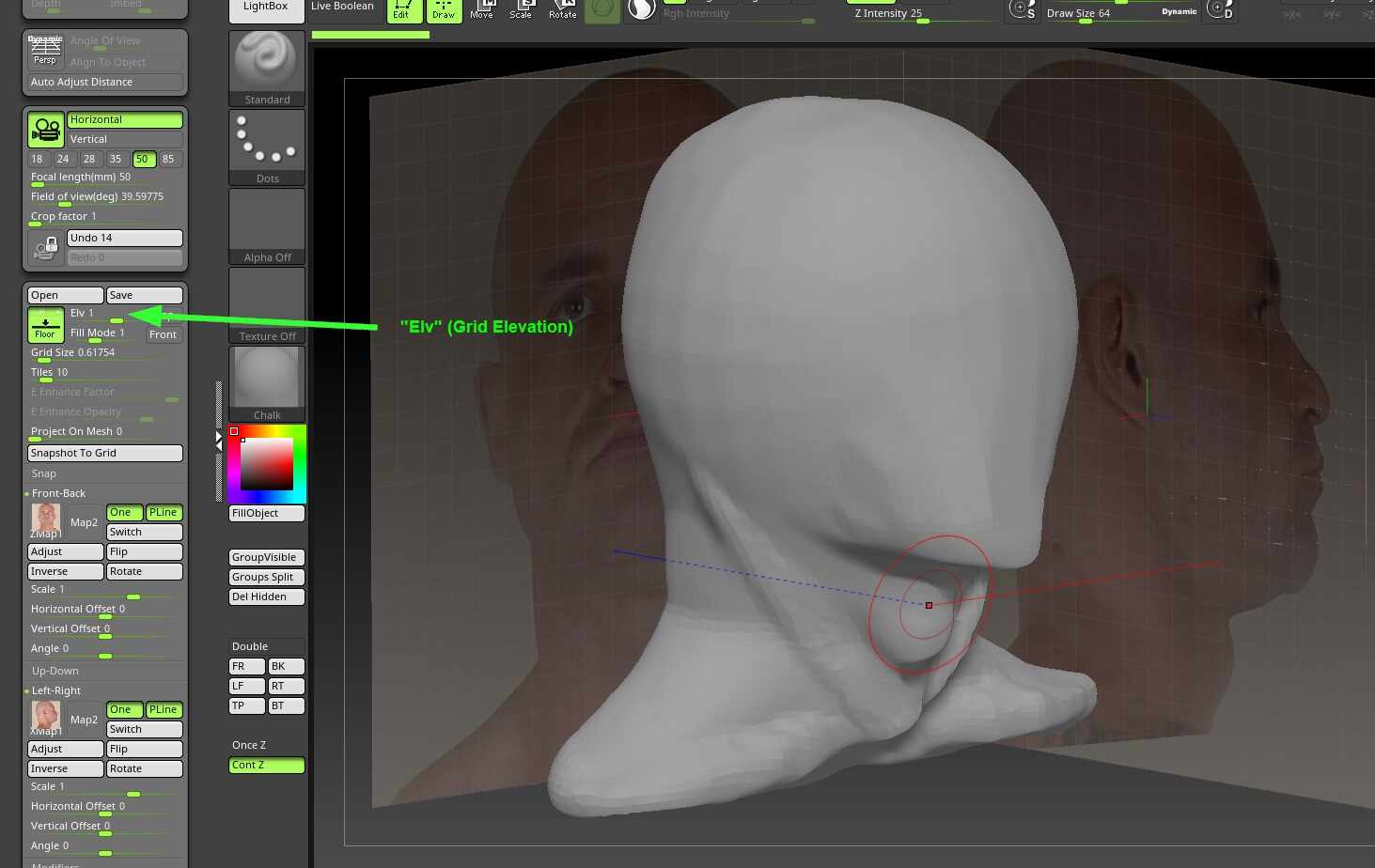

Hello, by following the course, I am shown how to add behind and on the side an image to help sculter, I never had any problems with these images, but now the images instead of being at “distance” from the sculture, find themselves in the middle as “centered” and I can’t manage with the parameters to move the one that should go to the back (right angle with the profile one), what did I miss? With which settings can I find the original settings? Thank you in advance!! Take care of yourself!

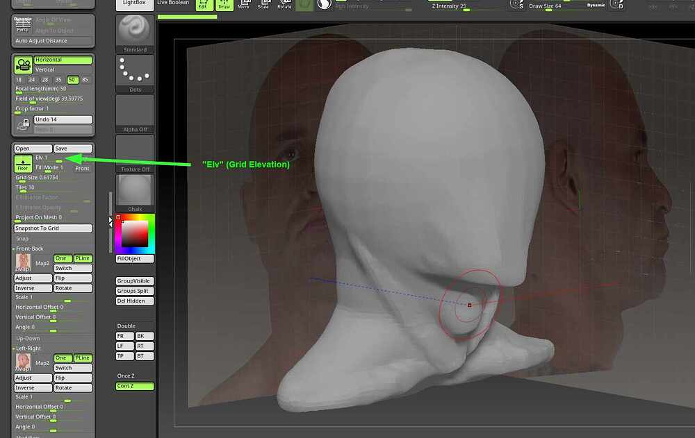

Go to “Draw” palette and change grid elevation to 1. The slider is very sensitive so it would be easier to just click on the slider to get the red number box and just type 1 on your keyboard.
Oh thank you so much !! i try all off this !!
