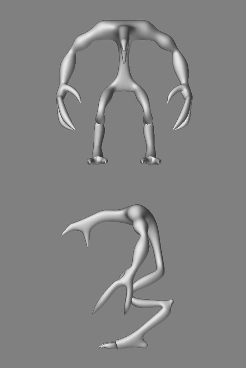

I’ve must of read like a zillion of threads about reposing your model from neutral pose to the one you want… but just can’t get “the Picture”. I’ve even tried the Pose-2-pose trick… but nothing.

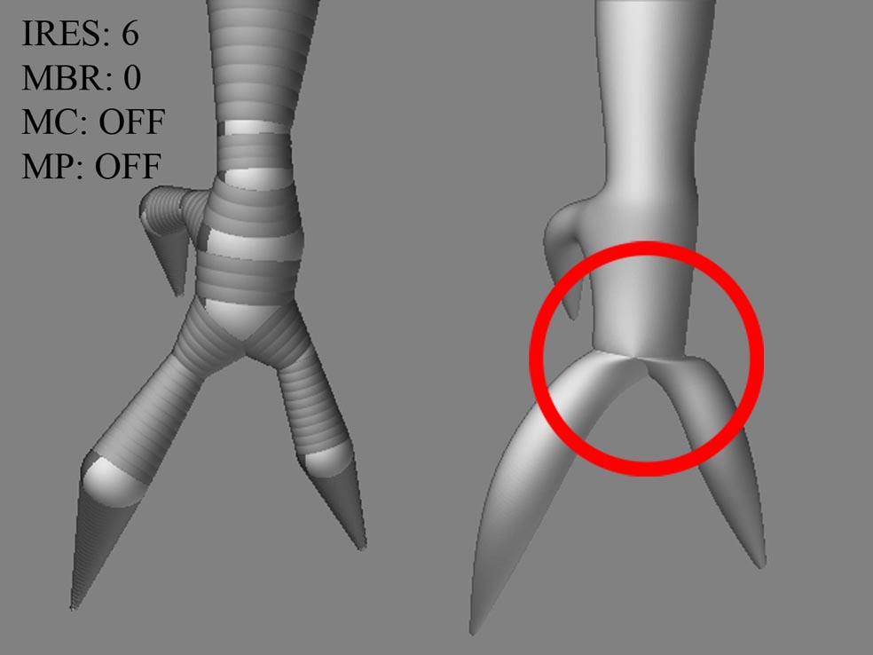

I’ve created a simple model and with the preview off, I click Store MT and then I should be able to repose it without any problem, right? Well… not my case… I do have problems -and I’m not just talking about my multiple personality disorder- I’m talking about some minor movements of the structure with zshperes and then with the preview on, some parts kind of breaks apart or when I go to the highest density there’s a very hard line that just will not disappear. I try to go to the lowest density to fix it, but it’s like the poligons are in different planes… let me show you…
Ladies and Gentelmen… I present you… my problem:
So as you can see… I’m REALLY STUCK here… so if ANYONE can help me… I’d really apreciate it.
Thanks

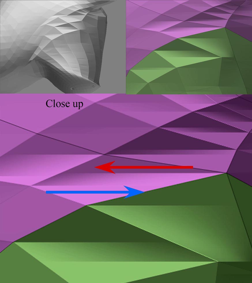

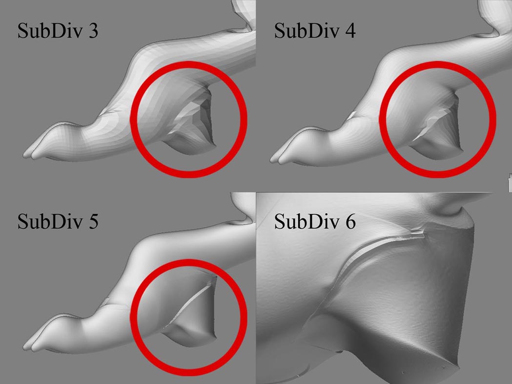

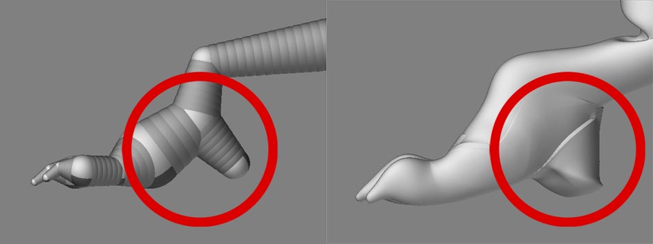

Well, regarding going down subdivisions and fixing the problem, here’s an attempt beginning from subdivision #3
The poligon that has the 2 arrows at a first view is on one plane, but as you can see, the arrows indicates some divisions within the same poligon that are not in the same plane -what I call “crossed poligons”- wich creates those “hard lines” in upper subdivisions.
I really don’t know if it has to do with the zsphere configuration or connection -parent/child- that I got messed up… and yes, I’ve tried out changing the membrane curvature, intersection resolution, minimal skin to child and parent… I’ve tried even doing a tribal dance around my PC to find a solution.

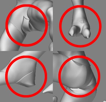

Here’s another example:
This is like going through a cave in the dark… the more you try to move further… the more you bump yourself
You’re hitting limits of zspheres. A few people have been able to pose them happily (see jason belec’s endless thread), most others find them more trouble than they’re worth.
You might be better off doing a make polymesh, then using the deformation palette to pose your creature (using the set temporary pivot button with deform->rotate). Not elegant, but it works.

One thing to pay attention too. When you first start putting down z-spheres you need to frequently preview the mesh. If you notice parts there the mesh overlaps then you need to move those spheres around a bit so the mesh doesn’t overlap, and do this before you start modifying the mesh.
That is True Mr. Robertson. I’ve been moving around zspheres more than I would like to just to get a good start in a neutral pose.
I’ve notice that when the links -branches, connections, or whatever you may want to call it- between more than one child that overlaps each other on a parent, the mesh tends to overlap too… although… this doesn’t seem to happen in Mr. Mestela’s -well explained- example http://www.pixolator.com/zbc/showthread.php?t=29617
I’m yet to figure out what I’m doing wrong.
But I do recommend to to see what Mr. Robertson pointed out by going to higher divisions, because what seems to have no mesh overlap at a low division might have it in a higher one.

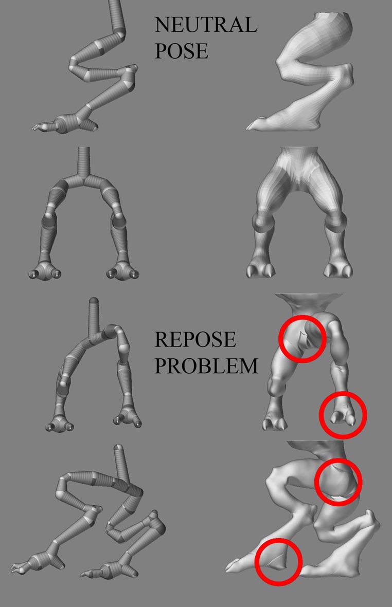

OK I recieved a special request for help. Let’s see if I can sum this up.
The problem being encountered is the fact that more than 1 rotaional axis is getting applied - big no no. It’s equivalent to gimble lock in animation rigs.
In post #1 second image where you move the zspheres.
  1. Before doing any modeling you must store the zsphere morph
  2. Before doing that you must Preview to see if you have any issues straight up. ie The heal geometry. Post #5 is also a good example of this problem.
  3. If you intend to rotate/move a zsphere or a chain between zspheres you must have reference zsphere’s either side to control the rotations, this is where you are having the most trouble.
An example is a shoulder, the first zsphere from the body is really the clavical area, the next is the shoulder joint, the next the shoulder, the next the upper arm. This means that you can control rotation on each area seperately and not affect the others. If you try to make a zsphere handle more than 1 axis you will get a mess.
4) Post #6, spread the toes wider apart, they are overlapping when you goto Preview mode. Before you even start modeling you should pose and test to make sure your underlying structure will work - otherwise why waste time modeling.
5) For those with little RAM, don’t go nuts and try to set the initial levels at 7 or 8, your system just won’t handle it (try 5 or 6 MAX). Way too many calculations. A solution exists, but I’ll post that in my thread at a later date. Not necessary here.
I hope this helps, most of the problems in this thread and issues people have with zspheres in general are from not testing at the initial stages. Everyone wants to jump in gung ho, and so did I at one time. However in the 20 or so years I’ve been doing this stuff, patience and planning has always been rewarded.
