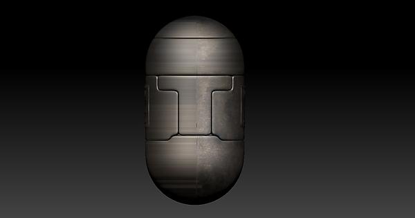

Following a tutorial, I’ve recently covered how to make a UV mesh, apply a texture and then Polypaint onto it. However, I’ve stumbled on a slight problem after applying some Polypaint. When I get it to re-apply the texture with the new Polypaint, the end result makes the left side skewed and blurry.

I’m not sure what’s happened or how to fix it. :-\
Can you share the tutorial so we can see what steps you took? Even seeing the UV map would be valuable information to share as it very likely relates to your problem (for example you’ll want the faces to be unique rather than stacked, with no edges touching the 0:1 borders).

Okay, I’m not 100% sure why, but after doing another UV Unwrap in UV Master, turning the subdivision back up, going into Texture Map, selecting New From Polypaint, that seems to have done it. I hope… I think what I might have done initially, is go into UV Map and do a Cylindrical UV.
The quick projection methods such as cylindrical and spherical in the UV menu are only really suitable for the simplest tasks. The default UVs that come with the primitives from the tool menu will probably work better. If UV master is overkill, and you just want a quick no-fuss UV map, look to one of the tile methods instead. These will get the job done, but wont be editable and some other programs may not like them. For any complicated subject like a character mesh, you’ll want to use UVM.
