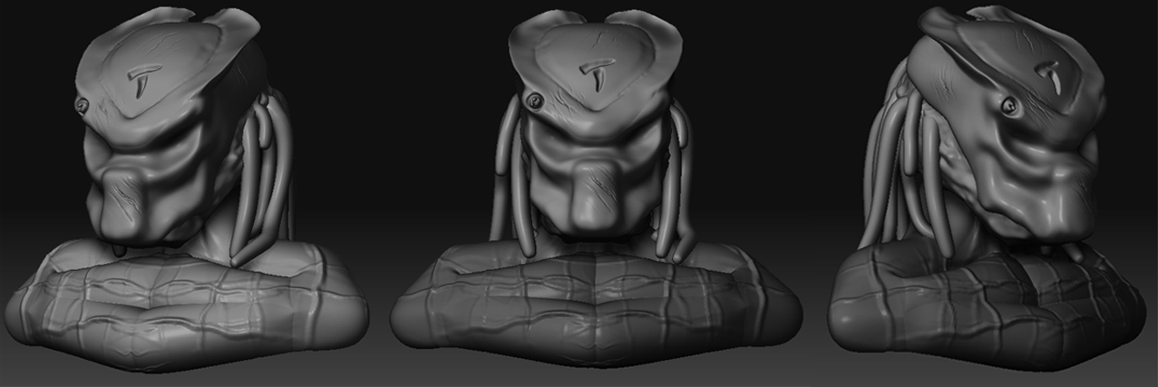

Hello Fellow Zbrushers,
This is my 2nd post, and is the Predator from “Alien Vs Predator” i am 15 and learning Zbrush any tips and ways which i can improve are appreciated. My Laptop isnt that good so i can only sub-divide to level 6
Thanks Nick

Nice job! I’ve actually got an AVP WIP on the back burner myself. Haven’t had much time for it lately. My home machine (512 XP) only goes to lvl 6 most times. Depends on the model mostly. I’m hoping to be able to afford an upgrade soon.
My only suggestion would be to drop back down to lvl 1, re-position some of your vertices and then work your way back up one level at a time. That’ll rid you of some of the blobbiness. I’d also smooth back out the details until you’ve got the contours with your polys just right. I was stubborn for a long time until I realized… that really does work like a charm and you end up with a much cleaner model in the end. Is this from a pm3d sphere? Other than that it looks really good so far. You’ve definitely got an eye for it. Keep pluggin’ away at this.

thanks for the comment and i shall drop back down to 1 and work my way up.
in responce to your question: the maske was a pm3d sphere the head was a pm3d sphere as a sub tool where as the dreadlocks and the body was Zspheres And once again thanks for your time :smiley:
