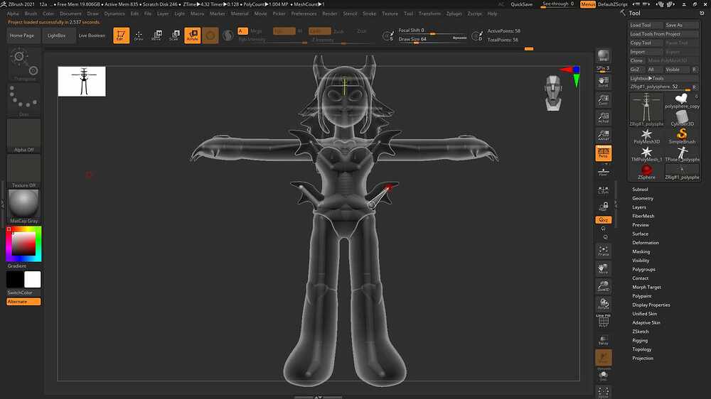

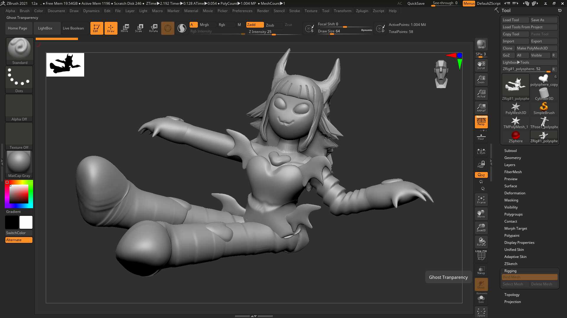

Hello! I’ve been using zsphere rigging to pose my characters. However, when I try anything more complex, the characters get wrinkled, like this:
Is there any way to work around it? I really enjoy the process of posing like this rather than using the transpose line.

Your mesh resolution is to high. If you are going to pose using rigging, it has to be done on a low subdivision level.

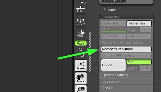

If you only had one subdivision level you could have tried “Reconstruct Subdiv” in “Tool > Geometry” (See image),but that will only work if you don’t have any triangles in the mesh or if you haven’t used ZRemesher. It’s always a good idea to keep all your subdivision levels until you are absolutely sure that you won’t need them anymore. You will probably have to use ZRemesher to get a reasonably low resolution for posing then subdivide the mesh for your detail, unless you can use an earlier iteration of the tool if you had one saved.
