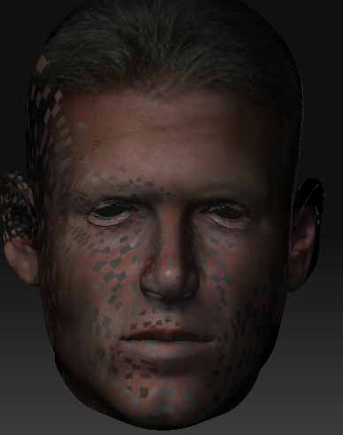

The texture is fine when in projection master, when I pick
it up the resulting texture looks like a horrible disease.

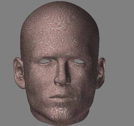

Import it into z3.
Crank polys up to a million ( problem makes it incidental)
Go into projection master.

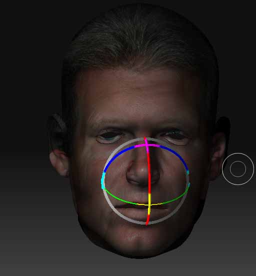

Create plane with texture attached ( only rgb turned on)
Attach texture to head, pick up.
Before it is picked up, it looks ok.

Nope, got desparate, went to z2 and tried Pm zapplink there.
In Photoshop looked fine, ended up with this.
