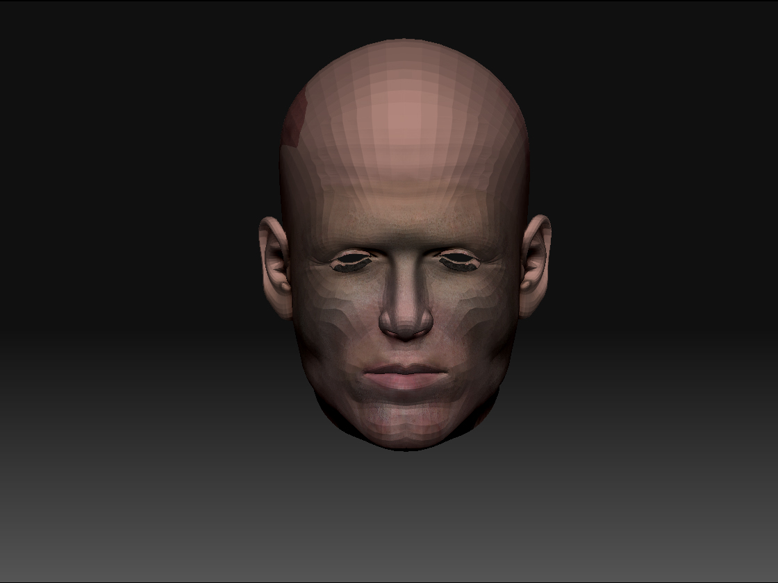

Right on. I have the original textures. But why when I bring in the texture does it not wrap the mesh correctly? Even after flipping horizontally, vertically or rotating I don’t get a proper fit.
What am I not doing correctly?
Can you show an image? That would perhaps help with finding what’s wrong.
You should only need to flip vertically. If the mesh has UVs the texture should then map correctly.

I got it to work. But the eye lash textures are separate from the head.
Do you mean that the eyelashes have a separate texture? If so, you would need to make the eyelashes a separate subtool as you can only apply one texture per tool/subtool in ZBrush.

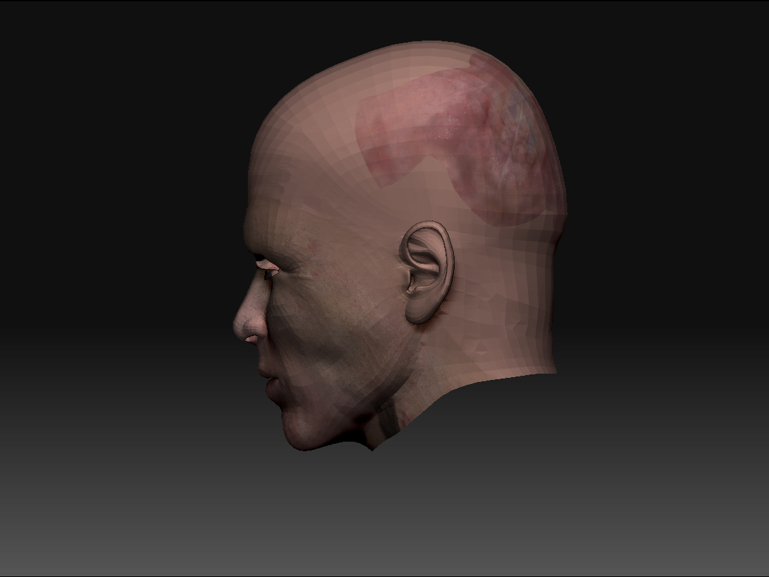

Did you also manage to apply the texture correctly to the back of his head (where the tongue etc.) were in your example? I have the problem, that the textures apply perfectly to the fact, but go wrong on the ears (strange) and the back of the head (which is a different MAT zone).
