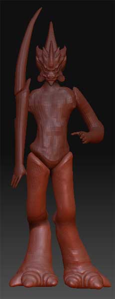

Below is a picture of my mesh and the problems I’m having…
[Posable_Symmetry.jpg]
You can see in the picture that I have 2 parts that need posable symmetry on. The torso has been twisted into a gestural pose but the geometry is perfectly symmetrical. The legs are actually just one object, imported in a perfectly mirrored state. I used transpose to put both the legs and torso into a more natural posed position…
When I select either sub-tool (legs or torso) and press the Posable Symmetry button along the X axis (and on the top sub-division level), nothing happens. My cursor doesn’t turn green and posable symmetry isn’t on or working at all.

Did you mean when you say geometry is symmetrical, you mean the topology? 'cause it appears your mesh topology isn’t symmetrical?.. That would cause posable symmetry to fail. And, on your edit: addendum, it appears you’re trying to use posable symmetry with transpose? It doesn’t work with transpose.
The topology is perfectly symmetrical. Using transpose, without masking, worked on the two pieces of geometry that make up the head. Using the same technique, transpose without masking, on his chest protector did not work.
Finally the legs and torso used both the tweak brush and transpose with and without masking to position them into place and symmetry doesn’t work with these objects at all.

The legs, while one Subtool, look to be 2 seperate meshes. I don’t think Posable Symmetry was ever intended to work on something like that.
I would understand that but Posable symmetry isn’t even working on the torso or the chest plate -which isn’t shown in the picture. I see no reason why it shouldn’t work on those 2 objects.
