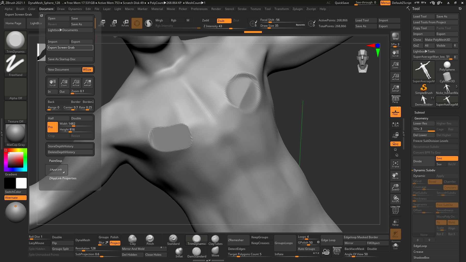

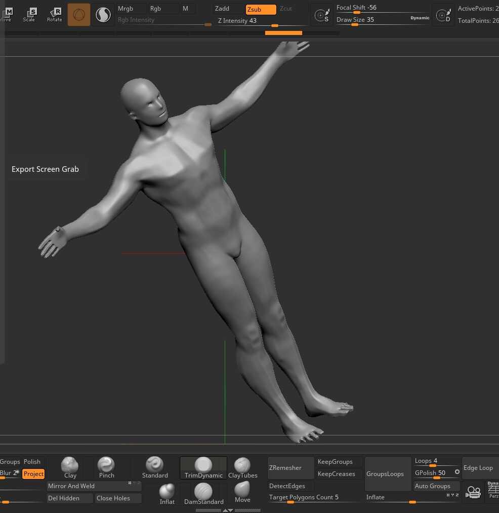

1. FINAL POSE WITH ALL THE SET UP EXPLAINED ABOVE. We are on the 3 subdiv level
ZBrush ScreenGrab01

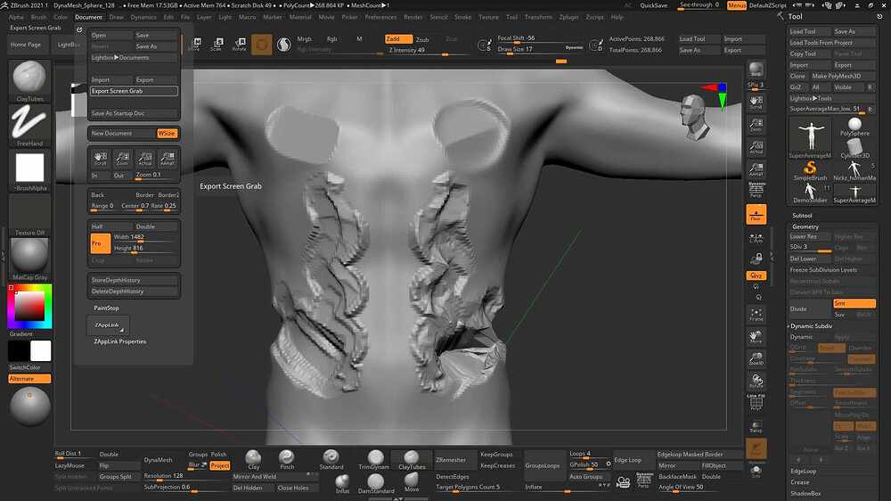

2. A SINGLE TRIM DYNAMIC CONTINUED STROKE. Issues straight away

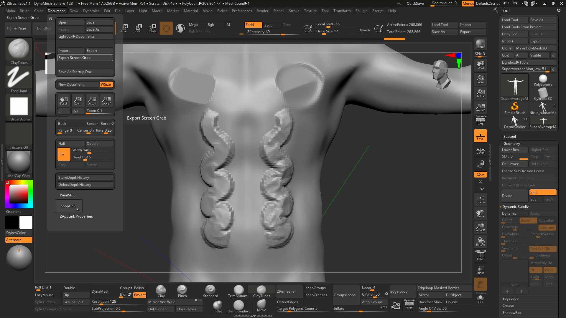

3. A SINGLE CLAY TUBES STROKE. Keen eyes will spot issues. Differences between sides.

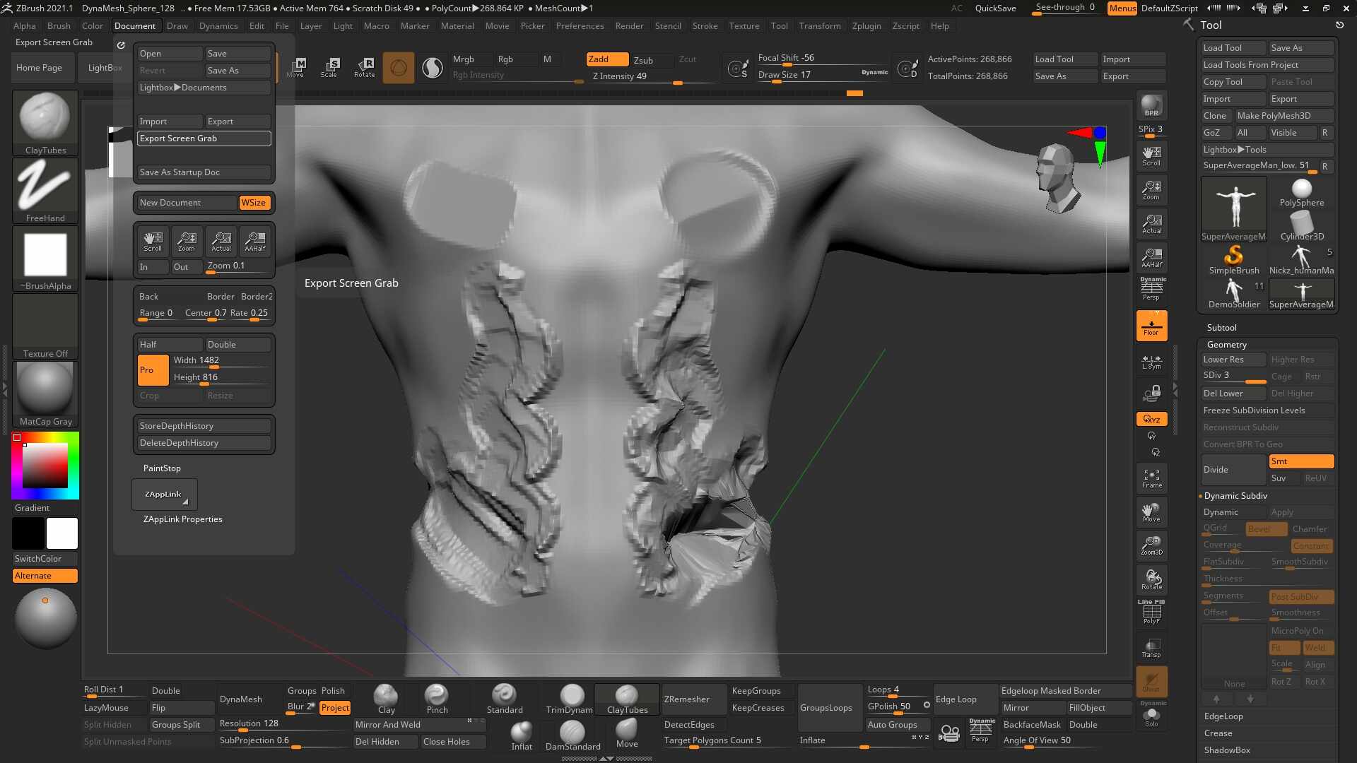

5. SEVERAL STROKES (not more than 10). You end up with an absolute broken mesh.
