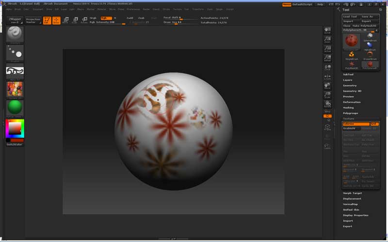

jinchoung,
I use polypainting a lot and have no problem using an alpha.
I just tested this (see screenshot) and I can use alphas to paint both colors and textures directly in polypaint.
[[attach=66949]polyalpha.jpg[/attach]]polyalpha.jpg
Check what kind of stroke you are using. If you are using freehand or dots, the alpha’d colors will smear together. Use drag rect, drag dot, or spray to see the shapes unsmeared.
He said with ZAdd/sub on, smarty pants.
Ah… actually he said with NO Zadd or Zsub.
Note the screenshot - ZADD and ZSUB are off, just straight polypainting, which is what he was asking about.
