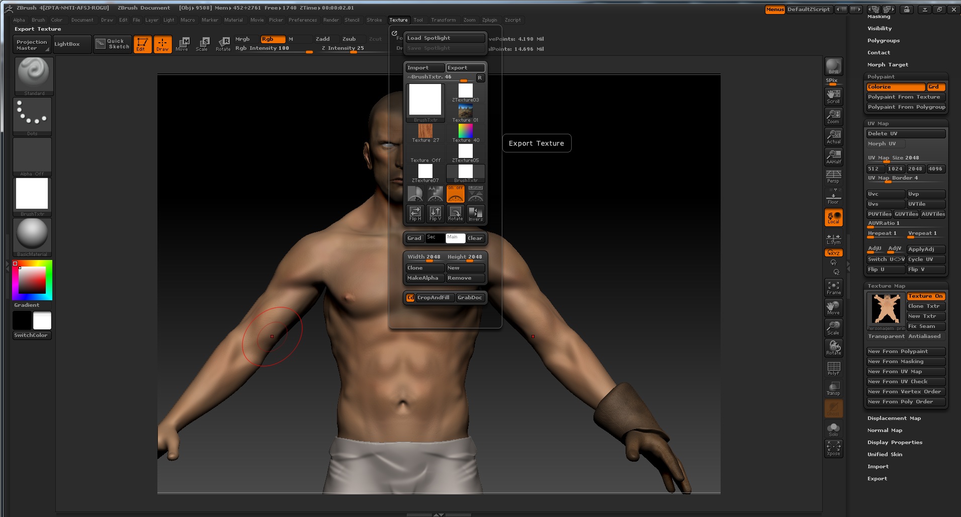

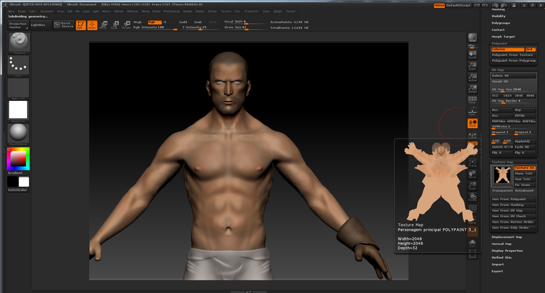

Look what I have here
[attach=266412]PROBLEM.jpg[/attach]
[attach=266413]PROBLEM2.jpg[/attach]
Do you guys understand?
Go to Tool > Texture Map submenu and click ‘Clone Txtr’. Then you can go to ‘Texture’ menu and export it.
Your tool is either corrupt, or you have no UV’s. I blame the guinea pigs.
Woah, I tried that at school and didn’t work O_O
Hahahaha, worked now! Thanks man!
No problem :slight_smile: Remember to do the same for Normal Map and Displacement Map when you want to export those. (Clone Txtr)
