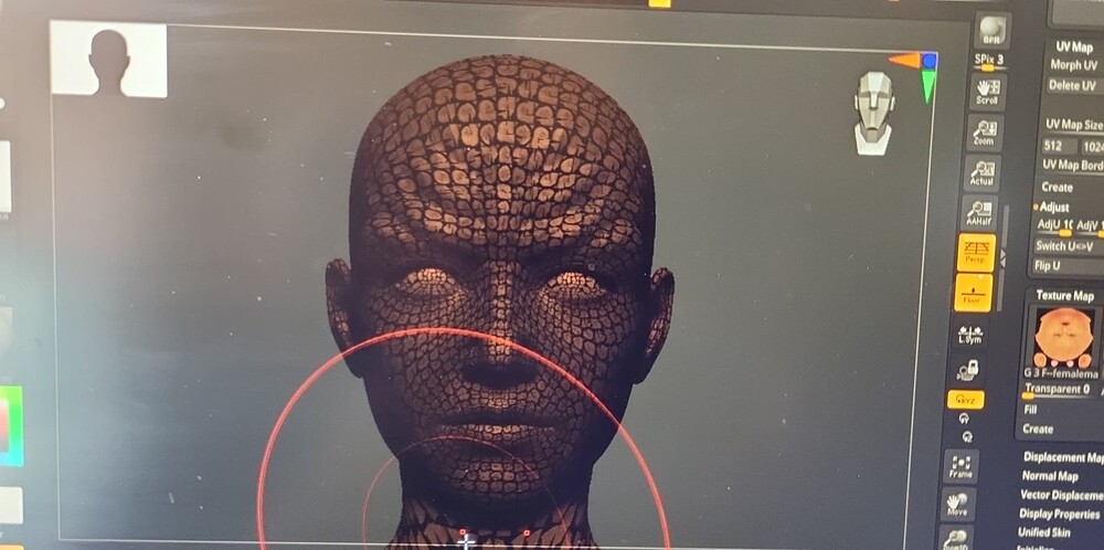

i have followed your how to my the leters , however when igo to polypain from texture the results are that each polygon has the complrte skin texture on it , instead of the texture geing aplyed to all . its a bit vexing seein 100 little face textures on the face , how can i fix this so that it looks right
