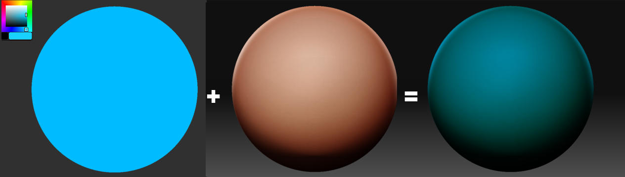

as you’ve already read its the materials which are causing you problems, just look at your tool with the flat setting in the render palette and you will see the true colors painted. you are painting white, but the material has its own color and is overriding/blending with it.
if you really look at the sumo, he is using the sculpy material for the whole model and those flowers are not actually white in the image due to the mat, but as stated if using flat mat or flat render the probably are.
imagine it this way, you take a green apple and coat it with red candy, do you expect it to be green or red, or something else, thats the way the mats work.

Any materials that you use are just render instructions to ZBrush, they don’t affect the texture or polypainting (and so aren’t transferred to any outside app). So painting with white will always reveal the pure material effect for the material that’s applied to that part of the model.
If you plan to render your model outside of ZBrush then choose a white based material to display your model in Zbrush. That way when you paint you’ll just see the color you’re painting.
If you’re going to render your model inside ZBrush then you can use embedded materials for different effects, using a ‘skin’ one for skin, ‘plastic’ for plastic and so on, safe in the knowledge that what you see is what you’ll get (making allowances for effects that show only with a Best Render).
To see what your model looks like without materials press Render>Flat.

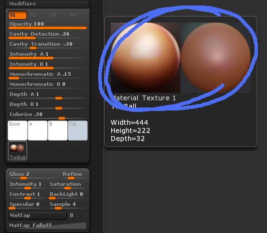

I try to avoid painting with Mrgb because I dont like the artifacts I get where the different materials meet. Regarding 3. -- Do you mean that I should adjust the modifiers in the material palette so that for example the beige matcap is white in the end? That only seems to be possible if I change the materials texture? Would this also change the lighting then?
[material modifiers.jpg](javascript:zb_insimg(‘153617’,‘material%20modifiers.jpg’,1,0))
I should mention that the green color gradient I get when I fill the beige material with a green color is also important to me.

  1. Select the material you like to use as a base and put it in one of the side trays so you can work with it.
  2. See in your picture the sliders called Monochromatic A and Monochromatic B? Push both all the way to the right.
  3. Save the material with a new name to your ZStarup\Materials folder.
  4. Restart ZBrush.
Your new material should be loaded in the Startup Matcaps. Use it to paint with white (or any other color) but you must have Mrgb on. However, as this is a close variant of your base material you shouldn’t get the artifacts you mention.
HTH,

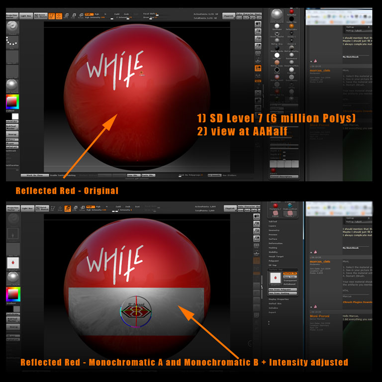

Here are the results based on the instructions.
Somethings that might help:
:large_orange_diamond: Subdivide your mesh
:large_orange_diamond: View at AAHalf
:large_orange_diamond: Adjust the Materials" S1> Intensity A slider to around 2.5
In My example the Doc size is 2048 x 2048 Viewed at AAHalf
(i use this as a default)
