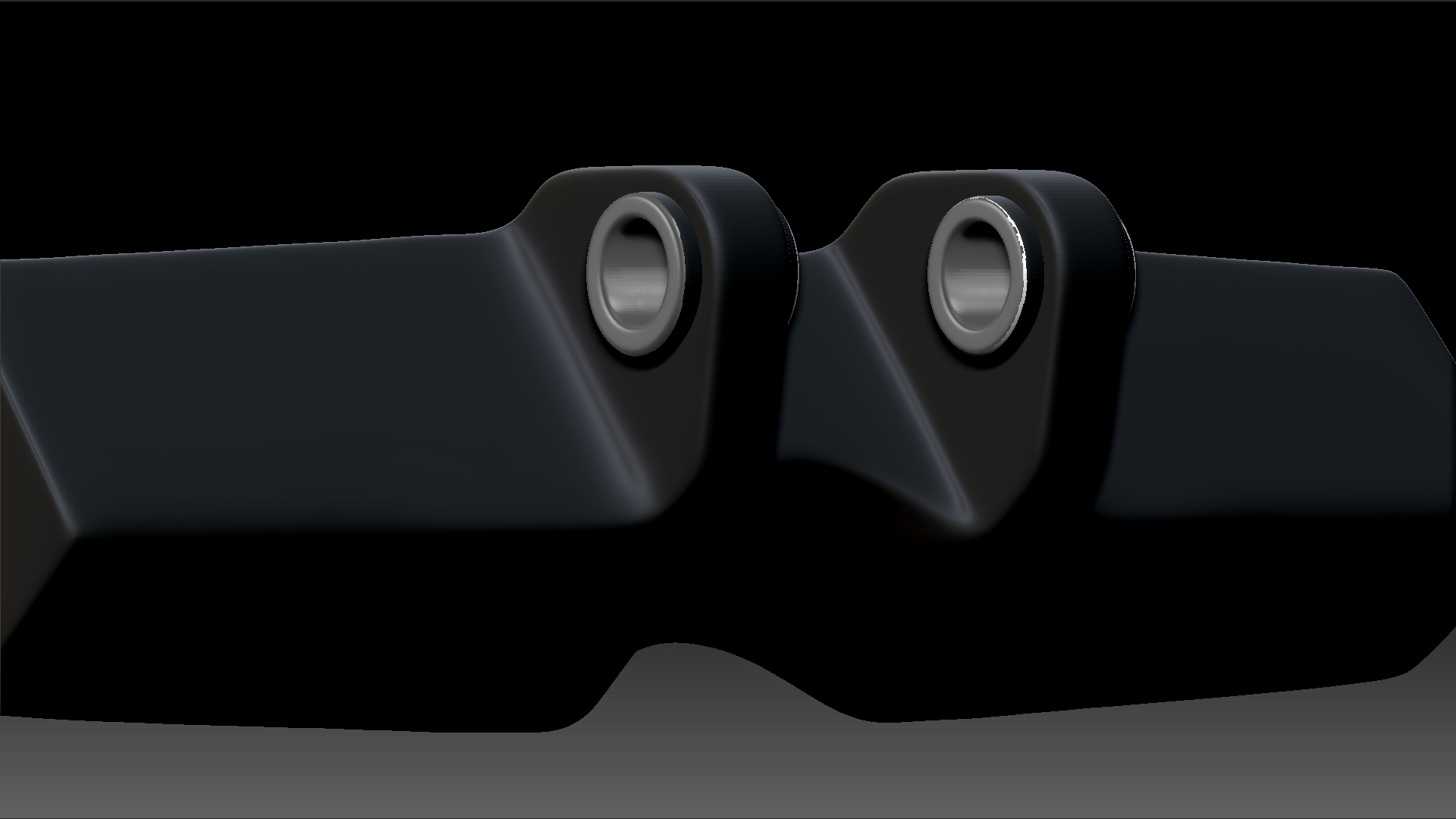

I understand that if I use polygroups I have some advantages: Masking, sculpting, painting…
I fail to understand what happens.

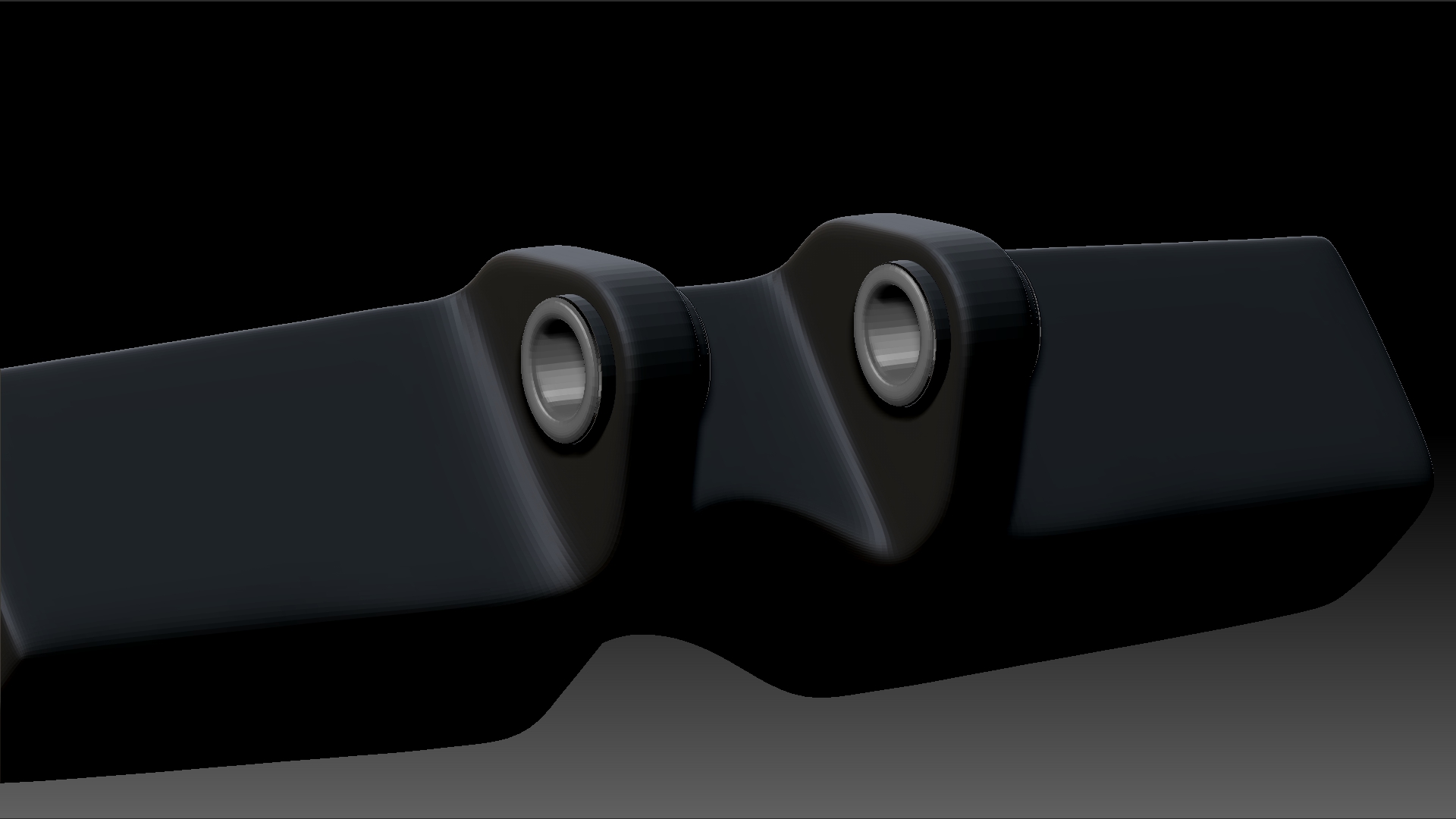

I have a subtool with some polygroups.
I painted the polygroup 1 with a Black material, the polgroup 2 with the same black material and polygroup 3 with some gray metal.
I do not understand why the two materials from polygroup 2 and 3 overlaps chaotic.
Should be painted uniformly on the edge, Since I painted each polygroup separately.
Can someone help me please!
Thanks!
You could do a group split. Then you can color and apply materials to each as needed. Not sure what’s happening, maybe your masks weren’t nice and clean, more geometry usually helps support your colors. If you’re trying to polypaint details, the geometry is necessary.

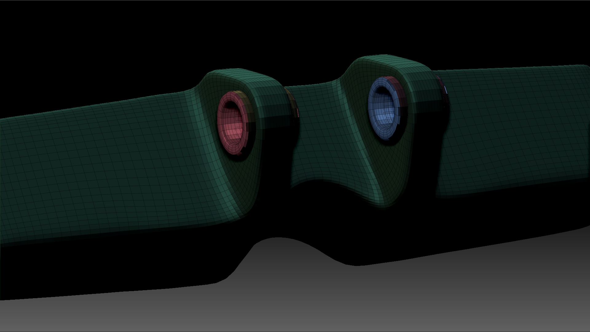

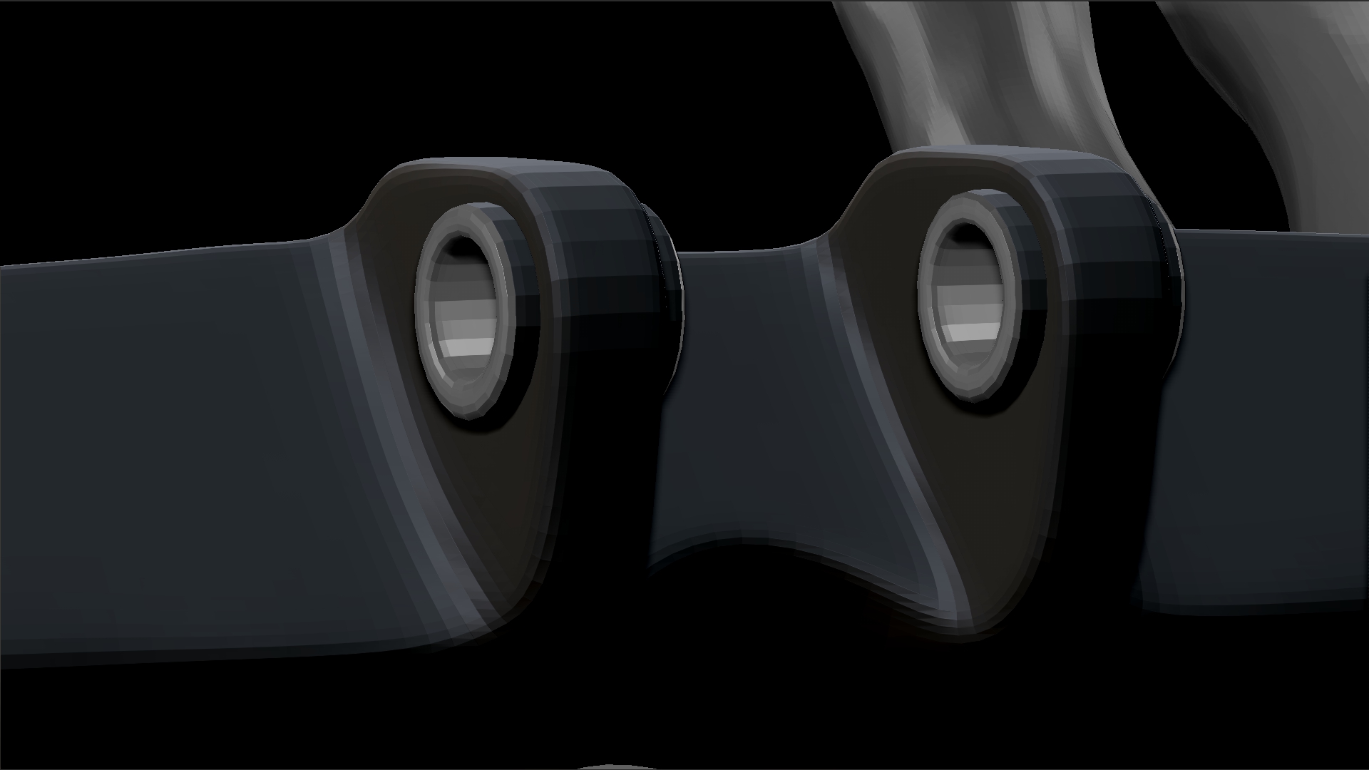

The green one is a polygroup., the pink one is polygroup 2 and the yellow oane is polygroup 3. How to split more than that?
I tried to paint groups at low res and hi res , 4 Sdiv level “869,120 active points”. the result is the same
I tried to paint a polygroup with masking other groups With a clean mask by hiding and using rectangle Masking mode
I tried to paint a polygroup with other polygroup hided.
Is like a gradient but gradient it isn’t active
Since they are separate groups should be painted uniformly on the edge.
When I Paint one of the polygroup 2 or 3. The polygroup painted is clear but the other one is not. And when I paint the other one the first one become messy. the color overlaps.

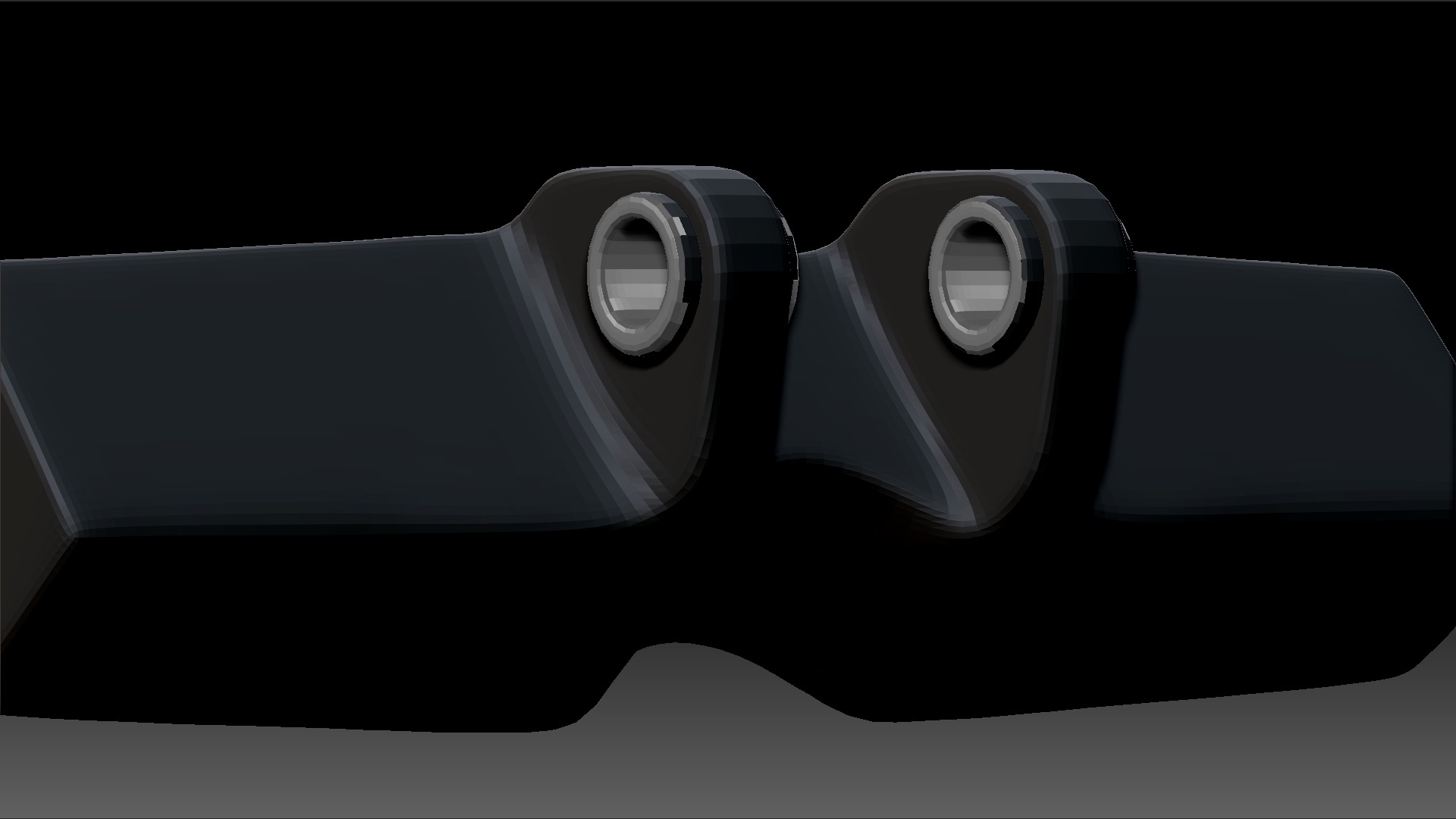

I tried to regroup, this time without a mask as they are already separated.
! when I use mask by group , the mask ovelaps.
The same rezult…
I mean to make them individual bits… The groups can be split so instead of 1 object you have 3.
Hi Doug!
I figured out what you mean by Group split
I made a group split and now is good, is clear.

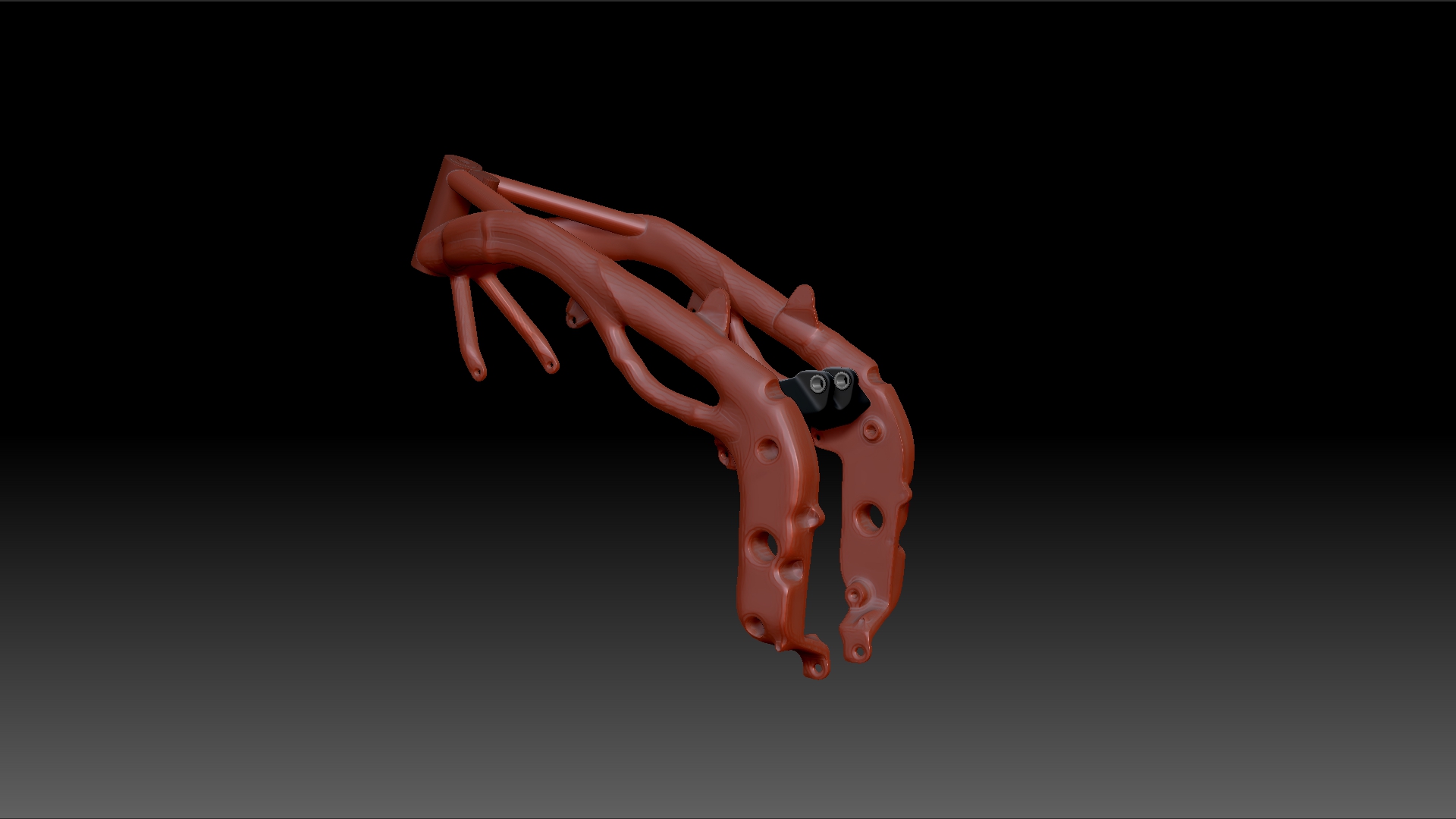

I am trying to reproduce a bike" triumph speed triple 1050" without blueprint. only thousand of reference picture
The main frame is a totaly pain

Somehow my start was with Zsphere.
Then using Dynamesh Somehow I started to lose ditail on the back of the frame when I was working on the front part.
Now I need to reconstruct.

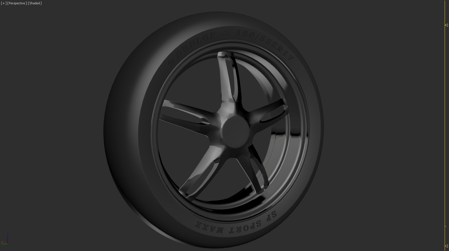

But where is many ditails I intend to use normal map

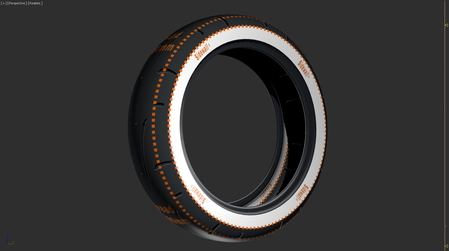

Like with tis tire witch I made
! If I merge the subtool without Weld option on, when I sdiv the subgroups are spaced from each other
! If I merge the subtool with Weld option on, the groupoly is subdivided ok but now I have the same rezul at the first time.
The 2 material overlaps chaotic.
Thanks Anyway!

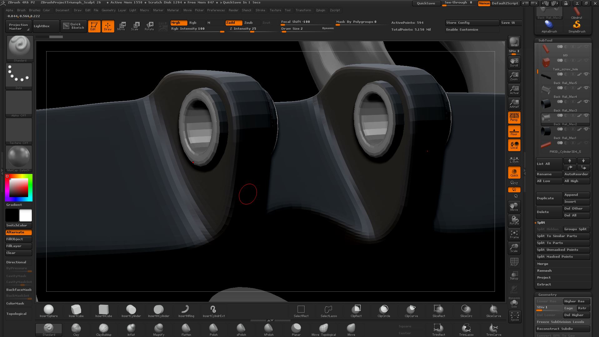

Crease the edge’s of the polygroups first (Tool > Geometry > Crease > Crease PG)
Thank you zber2. I tried your suggestion but same rezult. the 2 material overlaps chaotic.
If I use Group split the 2 materials aply fine and when I merge them with Weld on the overlaping effect come back even if you use Crease
It will work if you leave Weld off.

As for this particular model /issue, I believe there are a few things to consider if you want the caps of the cylinders to be a different material than the side of the cylinder.
- I find that if something is a separate object/material in real life, then its usually easier and more accurate to keep it separate on the model.
- If it’s not supposed to be physically different materials and you only want to emphasis the shape, RGB polypaint is the way to go.
- Materials can’t blend over a polygon like vertex colors/ RGB polypaint can. This is why its easier to split materials up, giving each their own unique vertices (which means you don’t want to weld them back to a single vertex once you do split them).
- You’ll want to crease the edges to hold the shape while the meshes are split, not welded
- An alternative, if you do want a single water-tight mesh, would be to add some very tiny edgeloops around the polygroups. This gives the material more room to make mistakes with the blending, as it will be smaller and harder to see.
- Be sure to isolate and fill your polygroups with the materials instead of painting or using masks. You’re more likely to get a crisper result as the others have a tendency to blend around the edges.

I think I understand what you mean… with weld of, the colors will not be overlapping anymore
And crease will keep the polygroups together when subdivided is applied.
