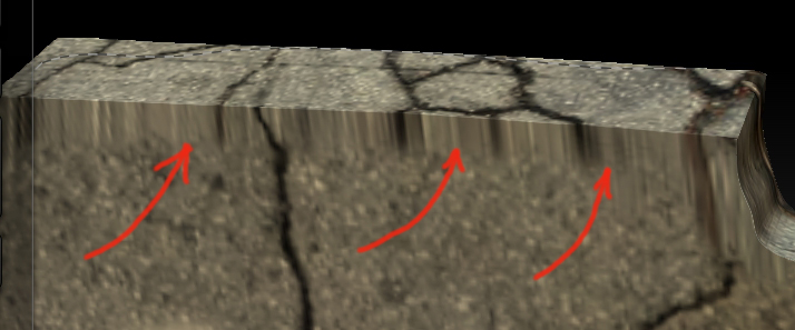

Hi guys,
Could you please suggest me any way completely isolate neighbor side from color injection when I am doing polypaint ?
Masking did not help because has same effect too, playing with automasking and tools/masking also gives nothing - still have issue.
May be someone can describe right techniques of doing this ?
Thanks in advance.

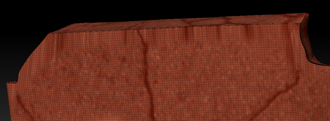

Hi, Bangers,
thank you for reply, but your assumption was wrong: mesh has high density:
So will continue my quest …
