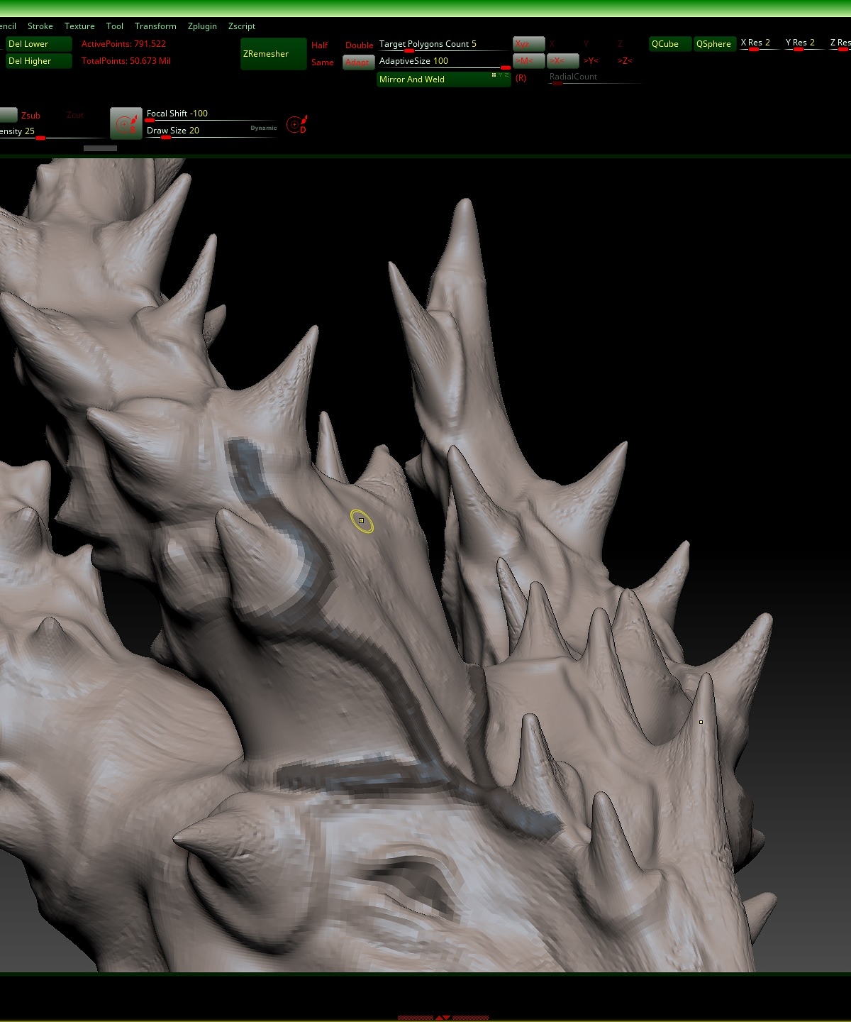

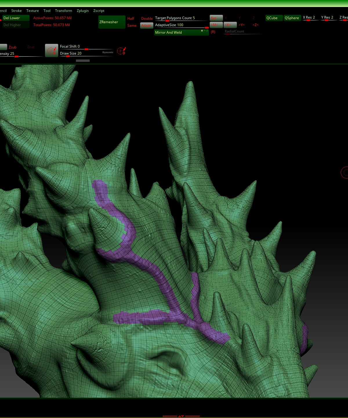

PolyGrouping was smooth when I saved, and opened all blocky
Yesterday I saved it and it was fine. I opened it today and the polygroups came out like the image. This is the second time. I fixed it after the first. Anyone know why this is happening?

I haven’t used Dynamic Subdivision or anything like that. But what I did do at one point in time was added PUVTiles as a temporary UV set so i could save my mask (which gave me a blocky result when I went to reapply it cause of the nature of PUVTiles).
When Polygrouping gave me a blocky result after reopening it the next day, I thought it might have something to do with it. So I deleted the Temp UV set and repolygrouped it from Masking again. As far as having this problem with other Meshes I’ve been gone from ZB for a long time.

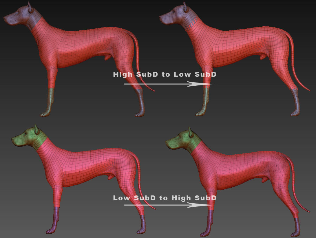

  1. Polygroups must be made at lowest level of subdivision. If you make them at the higher level of subdivision, you’re likely to make a rough border selection that cant be seen at high SubD. This border will visibly shift when switching to a lower subD level, and will remain shifted even when you switch back to the higher. You must make your polygroups at the lowest available subD level, with clean edge selections, and then they will maintain that border when switching to a higher subD level. See illustration below:

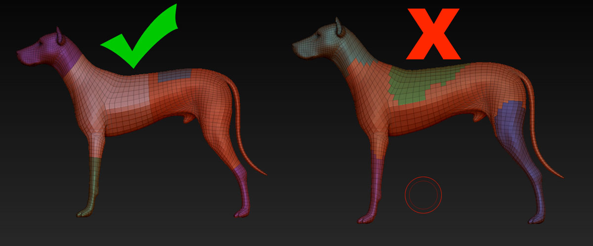

  1. Polygroups are limited by topology. In order for a polygroup to have a clean, crisp border, it must flow that way in the geometry. So when defining a polygroup, it is best to select polygons that are cleanly separated by edge loops.

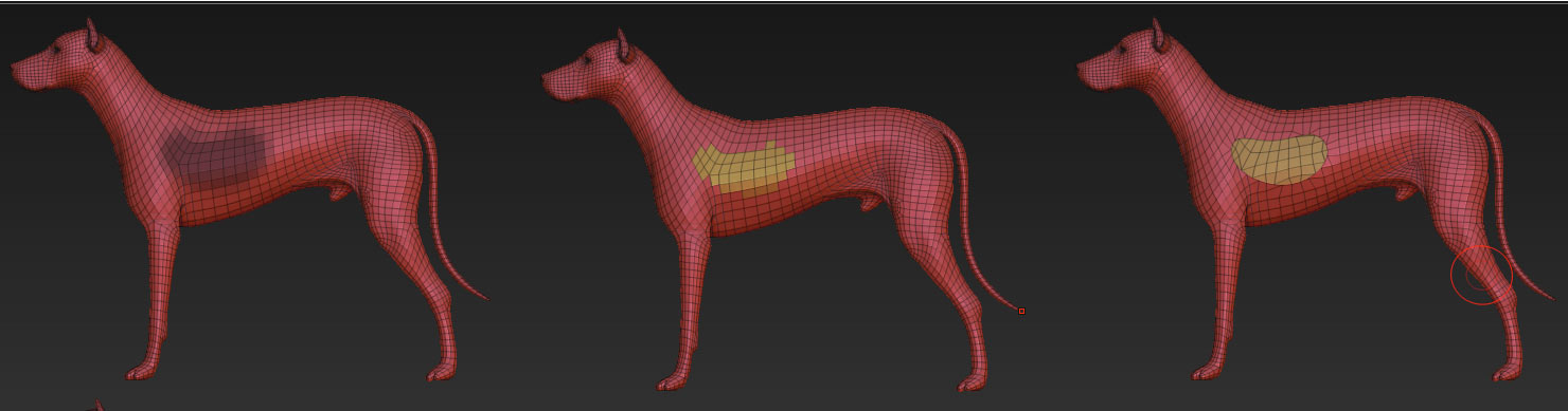

In your first response to my original post, you demonstrated that polygroups were still blocky while using a hand brushed mask selection at low poly. This is normal. Hand brushing your selection is likely to select a haphazard clump of polygons, which will result in a “blocky” border. If the topology doesn’t accommodate the shape you want to make, you will have to change the topology, for example with the Tool > Polygroup> Group Masked function with a polish value assigned, or with the slice brush. Otherwise you need to take care to only select polygons that form a clean border. See illustration below (the final image shows off group by masked with polish):
