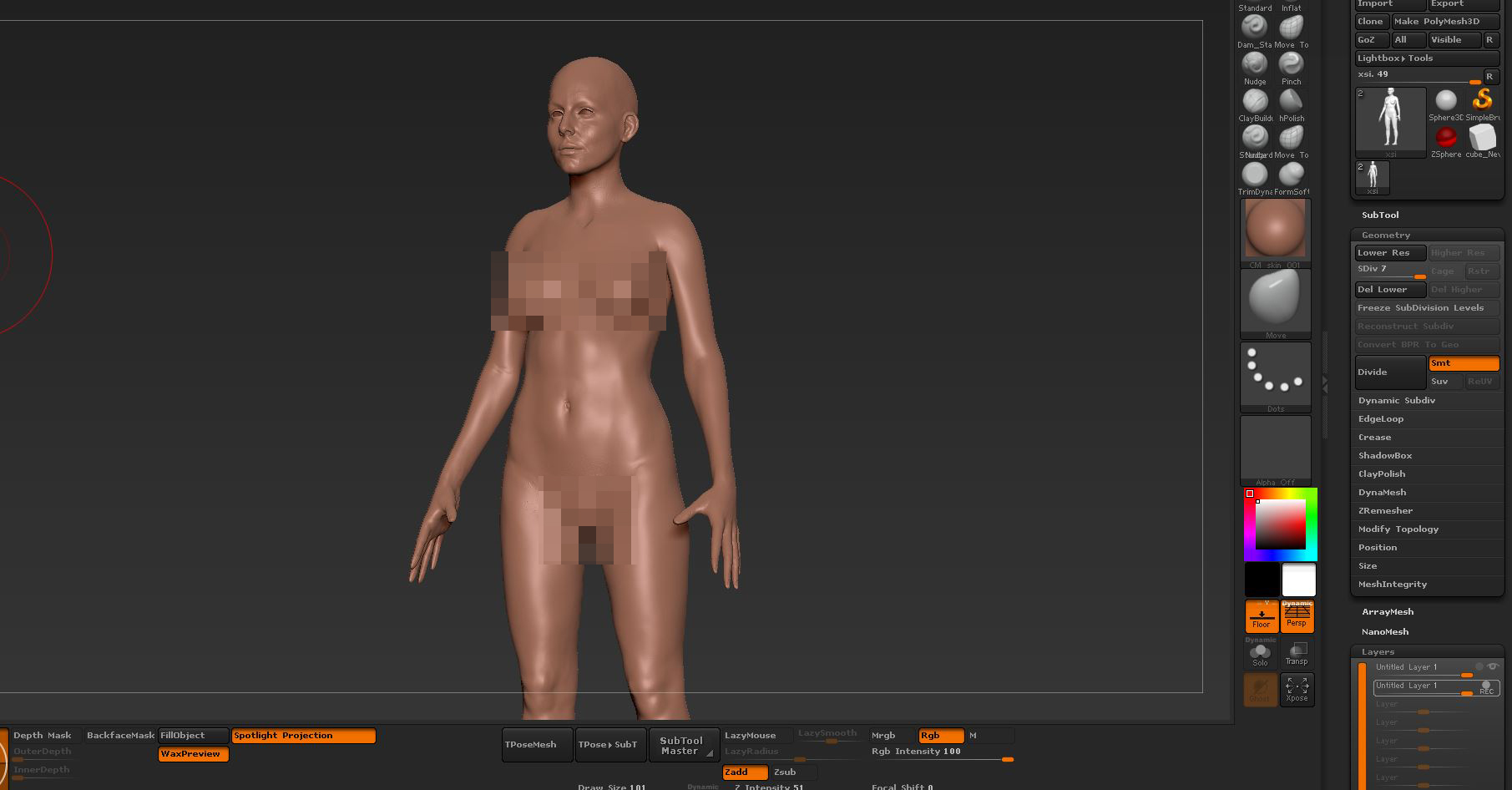

I have an intermittent issue I hope someone can help with. I have baked all layers, deleted any UV’s and materials/polypaint. Polygroups. Cleared all morph targets. Cleared any history of any kind I could think of.

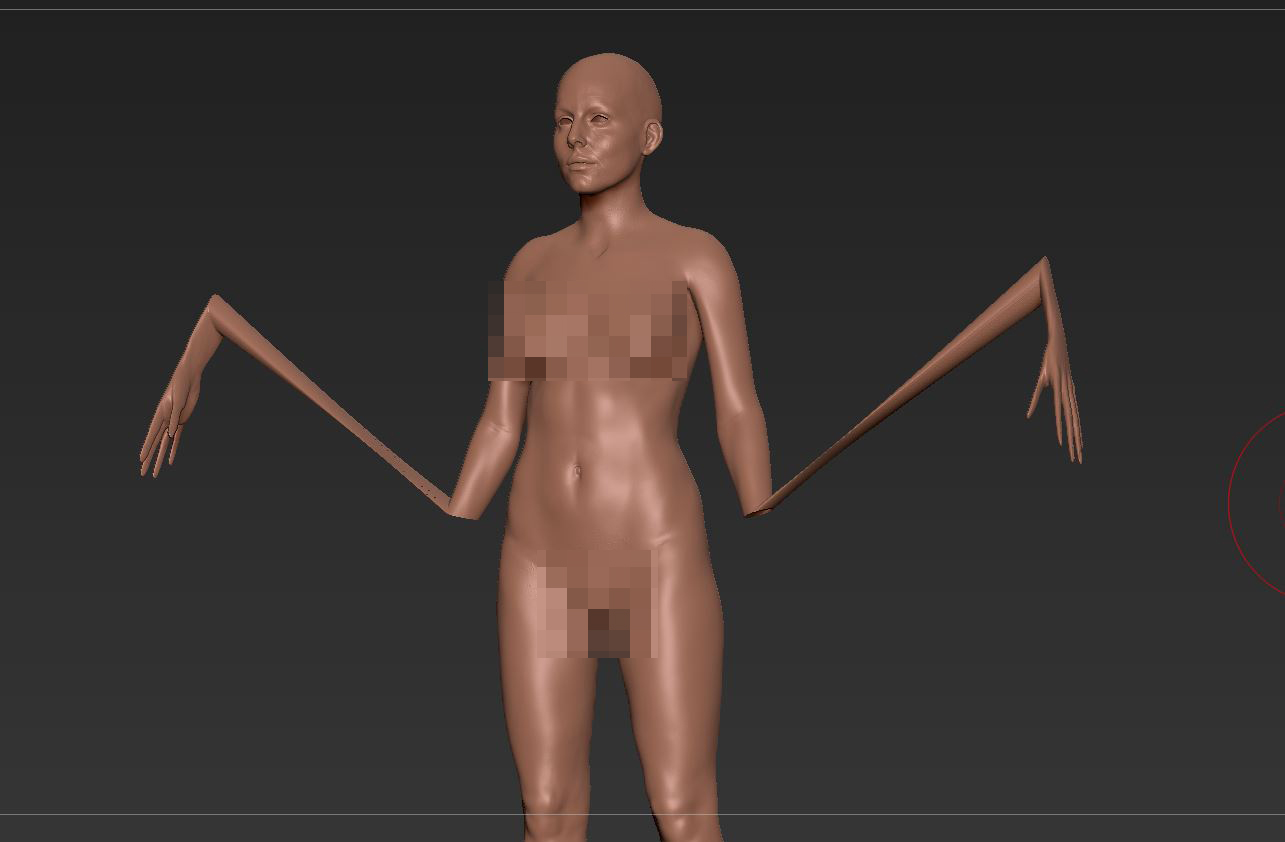

Now, when I make a new layer. Rotate the arms down. Turn off layer record. The hands skew off into space.
If I make a test layer and nudge the hands down with the move brush, Turn off layer record. Everything is fine.
If I make a test layer, go to lowest subdivision. Import morph target with arms down. Highest sub. Turn off layer record. Hands skew off into space.
Sometimes the hands skew off differently. Sometimes its just the fingers area. Sometimes the lower half of the arm. I don’t get it.

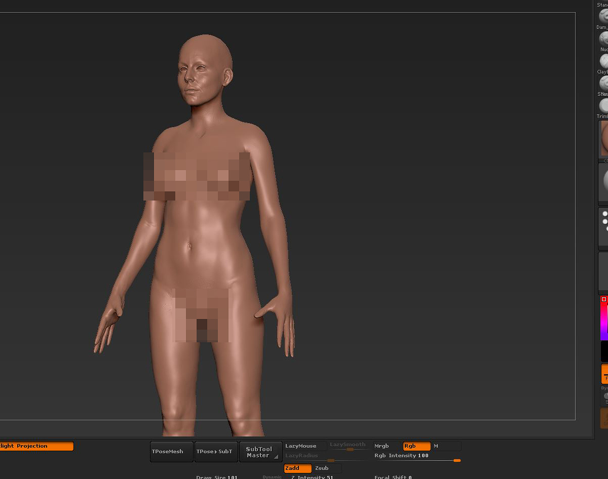

I have seen this happen if your model is too large for zbrush.
Under “Tool > Preview” does your entire model show up in that small window? For most models to work properly in zbrush your model should mostly fit inside of that small preview window. If it doesn’t you can try hitting, “Tool > Deformation > Unify” while your model is at it’s highest sub d level with no lower sub d levels. This will force your model to be at a size that zbrush prefers. After you resize, you can reconstruct the lower levels via “Tool > Geometry > Reconstruct Subdiv”.

You should be able to fix that via the export scale slider under “Tool > Export > Scale”.
