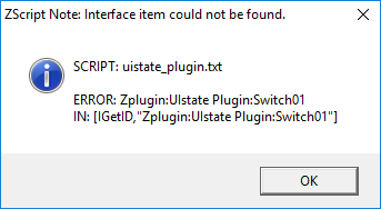

The main Issue happen when switch from plugin to another, which force zbrush to reexecute the script entirely with the startup Routine.
The Switch doesnāt work correctly, i have to click twice before it get again responsive to my click.
From what i know we need to delete the memoryblock after we change the button state. but when i have the [MemDelete, p_uiSwitchesState] line uncommented
when i click on the switch it tell me āThe Specified memory block couldnāt be found.ā
so i always keep it alive, which is no good at all.
