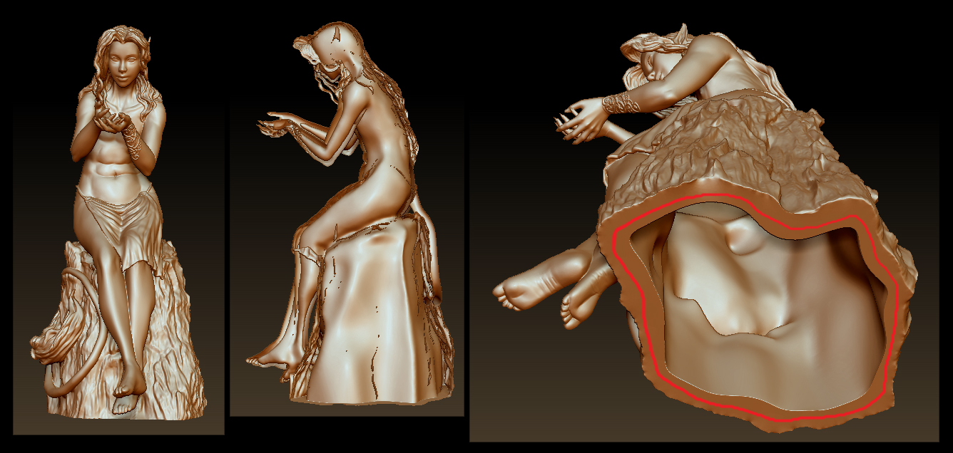

I have a somewhat complex, high-poly model (see attachment) that I am trying to prep for 3D printing. Somehow, the groups got all messed up. I had the inside wall nicely separated from the outside wall. I figured, well, Zbrush has a HUGE variety of ways to do things, there’s got to be some way for me to separate out the inside again. NOT THAT I’M !@#$%^&*ING AWARE OF. I seriously want to beat my head into the wall. I’m not even joking.

By this point I’ve been at it for hours and I am legitimately ready to start banging my head on a table. So I figured, ok, let me cut a border along the bottom (see attachment, third image, red line). Maybe Zbrush will let me separate my mesh by distinct shells. NOPE. Really? Zbrush, the program that does everything- mows my lawn, cleans windows, brings me breakfast in bed, and makes a mean margarita… doesn’t… have… a select shell function? You’ve got to be kidding me.
Anyway, to sum this up: I need to separate the model along that red line. How do I do it without utilizing Zremesher, decimation, or Dynamess? I’m just about at wit’s end here. I looked everywhere else for solutions and I found nothing. Normally, I am the biggest, most flamboyant, shameless Zbrush-cheerleading fangirl out there but tonight, I’m trying to stave off the impulse to buy another copy for the express purpose of watching with malicious glee as I set my microwave to “popcorn” and watch it burn.

Create the ring polygroup, then hide it so that you have the inside and outside visibly isolated. Then use Autogroups.
Would you want only two polygroups with that line being the seam? You could start that way above to split it into 3 main groups, then break up the ring’s polygroup and merge the parts how you see fit by isolating them and using the Group Visible option.
I AM SO FRIGGING HAPPY. You don’t understand. I’m going to like… cry. That’s how happy I am. Now pardon me, I must run around screaming like an idiot to relieve the painfully intense joy. Thanks. All the thanks. In fact, possibly every thank I have ever given. All of them. All at once.
