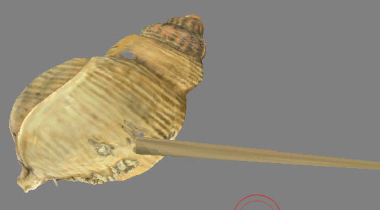

Ive been having big problems with my mesh, ive been making a seashell and on the whole its going really well but the problems are around the holes…
sometimes when i pop out of projection mode the mesh has gone all spiky and messy, i know this is because i painted on a perpendicular surface but sometimes that just cant be avoided.
i cant use smooth or nudge to rectify the problem because the problem area is around a hole, it has nothing to smooth back into.
instead the rest of the mesh smooths to the error area rather than smoothing out the error area!!zbrush help neeed.jpg
heres a pic of my prob… also does Zbrush have an autosave function like in max???
I’m glad Zbrush does not have an auto-save option. I always save when I think the object is ok. Sometimes I save it under another version name (like shelf2). So, when you saw the strange point on your shelf, you had to go back to the previous one or doing some ondo’s. The only thing you can do now is changing the object to the lowest level (Devide) and move the point back where it belongs.
Zbrush did not put that point there I think.
Please post the shelf when it’s finished, it looks good!
How do i move the point back?? using nudge is awkward and i move the points in one axis but then it has moved in a diiferent axis
arrrgh!
while in edit mode make brush size 1 and hit the move button then put the cursor over that one point and move it back.

I forgot to ask…is this a zsphere model in preview mode? Or is it already skinned obj?
This thread contains instructions by 3DP on how to restore the stray vertex.

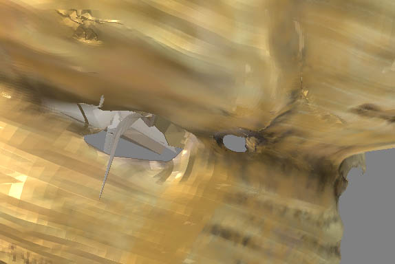

mmm still having a few problems, its a complex lil hole where all the action has gone wrong, is there a way to contrain the move to only one axis???
help meeeee.jpg Ive tried sorting out L1 then disp L2 etc but i just keep mving them in the wrong axis!

Ive been experiementing with this this week too, because I too have a problematic mesh Imn working with right now. Sadly, ZB just seems to do this every now and then, and I havent figured out what the exact circumstances , or what mesh characteristics make it happen. I can however, tell you what, Im my experience, greatly reduces the frequency of these incidents and the fastest ways Ive found to deal with it.
  1. I actually think this is an issue that has more to do with the textures or uv coords on the meshes, than the geometry itself, although it ends up affecting the geometry. Remove your texture (texture menu>remove) from the mesh before doing any geometrical transformations to the mesh…this includes editing, deforming, or even going up and down subd levels. Only apply the texture when your are painting the texture itself, rendering, or preparing to save the tool (so it exports with the tool).
When you remove the texture it will be gone from the top menu bar texture menu, but still availiable via the texture menu on the left. As long as you are working in a saved document, dedicated to your tools, that saves material information, you should bve able to re apply it any time untill you close the file (mat info will save, but the texture wont unless you save it with the tool)as long as you dont reassign new uv coords.
This may not be ideal, but by doing this, and I am quite certain, I have vastly decreased (to almost zero) the amount of random errors and flyaway vertices that were being generated before. And you really want a texture- less mesh to maximize editibility anyways, when it starts getting resource intensive, even though its so alluring to have all those wonderful shaders applied when youre actually sculpting to see them change in real time.
The only other time that I would get these errors, is when I picked up when using projection master. Theres the known issue when painting deformation over an edge in pm, it can cause flyaways, but it also seem to cause a flaw every now and then when just painting with regular colour and picking up. You should examine your mesh after every pickup. The flaws make your mesh unstable if undetected, and commonly get worse, especially when going up and down subd levels…either resulting in that phenomenon where you go up or down a level and the whole mesh goes to hell, or it just crashes the program.
If you detect a flaw, and all youve been doing is texture painting, then the easiest thing to do is just hit “undo” till you reach the point where you picked it up. Painted material and texture information will not be undone, so you wont loose it. If youve passed the point of no return, you can repair the mesh manually as in the thread aurick linked you too, though theres no doubt this can be a pain…or…something that Ive started doing, I save out an OBJ of the base mesh at level 1 everytime I make any sort fundamental change in the geometry (adding, deleting polys, selective subdividing, as the geometry has tobe exactly the same to re-import it)). I do this rather than having to devote file memory to storing a morph target. Most of the time Importing this levl 1 obj back into the active tool at level one, will fix the flaws in the higher levels, without losing much or any of the hi level detail youve sculpted in.
Saving so frequently, in so many different file versions is a bit of a nerve racking way to work, but to be fair, zb is far from the only 3d app I feel compelled to do this in. I look forward to when Pixologic gets this ironed out.
But when you so brilliantly rewrite the book on 3d image generation, I suppose you have to expect a bit of wonkiness.
P.S. It should be noted, I really started to notice these errors after switching to to Silo to do my basic meshwork, from a Wings/Lightwave tandem previously. However, that was also the same time I started viewing ZB as more of a final output solution and doing so much more sculpting, painting, material mapping, etc., whereas before I had only used it for mesh enhancement, and displacement map generation, so the relationship could be entirely spurious.

I think the majority of the problems came from projection master, painting perpedicular…the mesh is horrid to sort out, it was fine when i imported it orginally from max low poly, I used tri to quad 90 and all that, its just all went wrong fairly recently
ive decided its the holes that suffer the most because youre painting at an edge and theres a surface behind that hole that gets moved, must start using the hide options, im a total am at zbrush still so youll have to bear with me…:slight_smile:

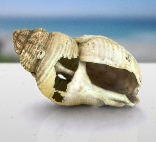

thanks a million for all your help, i got everything working just fine in the end although i had to sort out my displacement maps with photoshops LEVELS command quite seveerly to get it out of extreme mid range grey flatness, is there some way of changing how it exports this?
any ways heres the finished work for your crits, let me know what ya think im well pleased with it.
Tom
Hey Tom, let me ask you a question. I seem to develop these sort of flyaways most often with meshes that have gaps in the surface. Not a sculpted “hole”, but areas where I have deleted polygons from the mesh for reasons of optimization, because they wont be visible, and therefore make gaps in the meshes surface where you can see into the meshes non-normalized interior.
Based on one of your earlier screenies, it looked like this might be the case with the mesh you were working on too, that caused you all the trouble. Is this correct?
