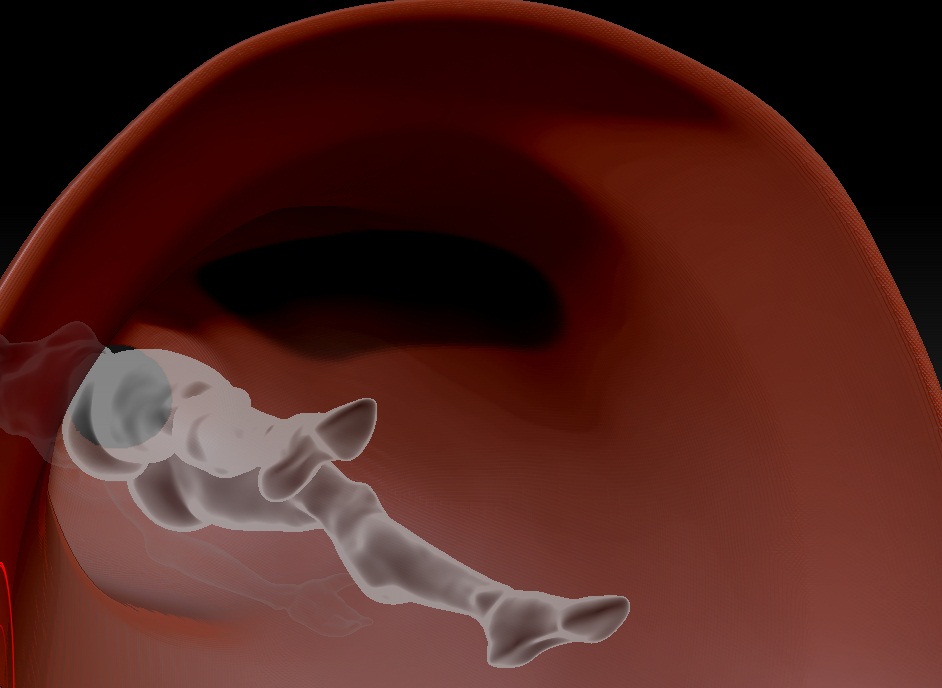

Thanks for the reply,
this is my problem right now:
When I hit ctrl and paint in the front of the skirt, I get this inside.
The only thing I want is to be able to mask the top without it masking
inside. I know it can be done because I’ve seen people do it, but no matter
what I try nothing works.
Even if I use polygroups and it works I will never be able to find out what I’m
doing wrong with masking… :frowning:
You’re not necessarily doing anything wrong. There’s always been a bit of bleed through when masking with large brush falloffs on thin volumes. At least, there was in zbr6. Backface mask works much better when you’re actually sculpting or painting, than it does for masking.
Keep in mind there are other options for auto masking in the brush >automasking menu, like topological masking, that may be of help.
It would be best, however, to become very comfortable with polygroups and the associated visibility shortcuts. It will make issues like this seem trivial.

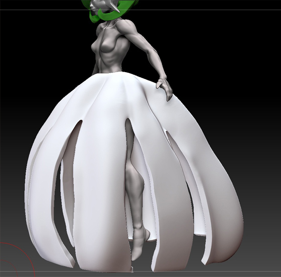

Ah ok, Group by normals kinda works but it also makes a couple of other random
poly groups. This is what I have so far:
It took me several hours just to get this much U_U
but now’s the big problem, how do I shape them to look
like moving cloth? I’m using the move tool but it’s almost
impossible…
Or did I have to model them like that directly and is not possible
to pose them now?
If you draw them out with the topology brush, you should be able to create them as low poly geometry that would be easier to pose. Likewise you can run those through ZRemesher to create lower poly versions that might be easier to move verts around with.
Otherwise, if you were going to extract them, it might be better to extract them from a solid shape you had already sculpted into more or less the correct form.
The trick to using the Move brush is to adjust your brush size and falloff. It may be helpful to switch off dynamic size mode of the brush, so you can get really large falloffs. That way your move will be applied more evenly to the whole cloth, and not a small part of it.
If I were doing this, I’d create the extensions as low poly single plane geometry with the topology brush and a thickness of zero. I would then move the points around where I wanted them, then give them some thickness with QMesh, subdivide them up, and sculpt more detail into them.
