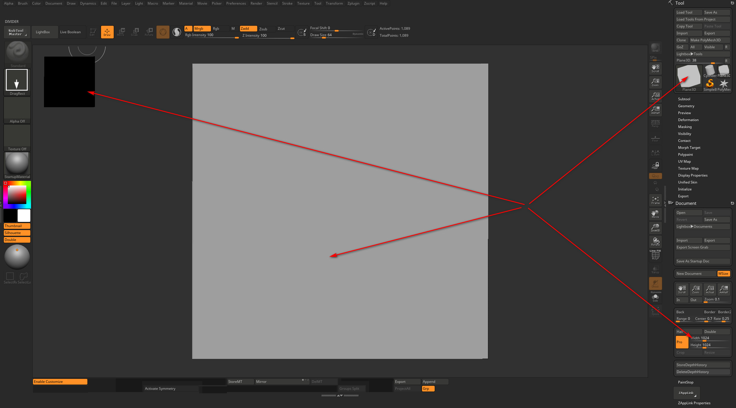

If I set the document size to 1024, drag the Plan3D onto the canvas, make Polymesh 3D and hit the “F” key to fill the frame it works perfectly. (See image)
If I set the document size to 2048 and repeat the process the Plan3D does not fit the document when I hit the “F” key.
How do I change/resize the Plan3D so that it fits fully a 2048 document?
Hi @embalse
The “F” key frames the mesh to the canvas size first. If your document is bigger than the canvas, you will have to zoom out the document (Document > Zoom) until you see it’s borders, then the “F” key will fit the Plane3D to the document size. Remember that when you change the document size and make it bigger, ZBrush will not automatically fit it to the canvas size. You have to zoom it out manually to see the whole thing.
