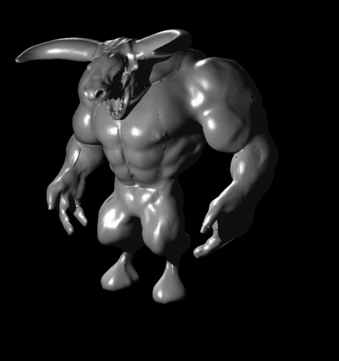

Hello, i have no reply from my post, so i decide to upload a image for a clearer view, hoping someone could see easily what is happening to me while i try to import a obj with a displacement . following zpipelines xsi 5 tutorial.
If somebody knows why this seems appear plis help me.
thanks!
Maybe you need to fix seams, try to convert your alpha into texture, and then apply TOOL > TEXTURE > FSBORDER, you need to put the amount of the fixed borders and the Apply fix
That was brillaint - thanks a lot guys, that really helps me out beond anything else i’ve read. Great stuff! Thanks a lot
