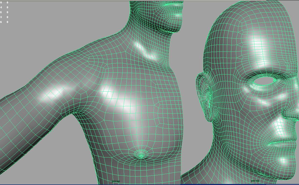

What was the overall workflow when creating Dr. Manhattan?
The overall workflow began with scan data of the actor who performed Dr. Manhattan, Billy Crudup, and a body builder who was the body double, Greg Plitt. Billy’s head was scanned, and Greg’s body, hands and feet were scanned separately. Once I’d created the rough mesh from another application of Doc using portions from the various scans, I took the mesh into ZBrush, subdivided it a few times and then used the projection tools to extract more details from the scan data. I had to do it in pieces and then export out maps for each piece. I then reapplied each displacement map to the model until I had the detail from the scans roughed in on the entire model. I then began the sculpting phase. Doc looks somewhat like the
source material, but he’s much more exaggerated detailed than what could be derived from simply scanning.

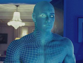

[attach=153777]Dr. Manhattan and Laurie Kiss[/attach]
Warner Bros. Pictures, Paramount Pictures and Legendary Pictures Watchmen,distributed by Warner Bros. Pictures. PHOTOGRAPHS TO BE USED SOLELY FOR ADVERTISING, PROMOTION, PUBLICITY OR REVIEWS OF THIS SPECIFIC MOTION PICTURE AND TO REMAIN THE PROPERTY OF THE STUDIO. NOT FOR SALE OR REDISTRIBUTION.
The veins you were talking about a moment ago were surface sculpts. But while watching the movie I noticed a few times where energy was flowing underneath the character’s skin. That’s not something that is seen in the book. How did the idea come about, and how was it done?
For the energy running under the skin. I built a series of curves that mimic not only the veins and nervous system of the body, but also the directional flow of the muscle fibers. The curves were then handed over to the big brain dynamics/rendering people who worked their magic. They used caustics, and somehow ran energy along these curves. It was amazing the first time I got to see it working. Those guys are amazing. Likewise, Elbert Yen, who was the texture painter, is amazing. He took the displacement maps that I exported out of ZBrush, and used these as a jumping off point for the final maps. I had worked with Elbert on “I AM LEGEND,” and there was such a trust between us, and that is the most important thing in production.

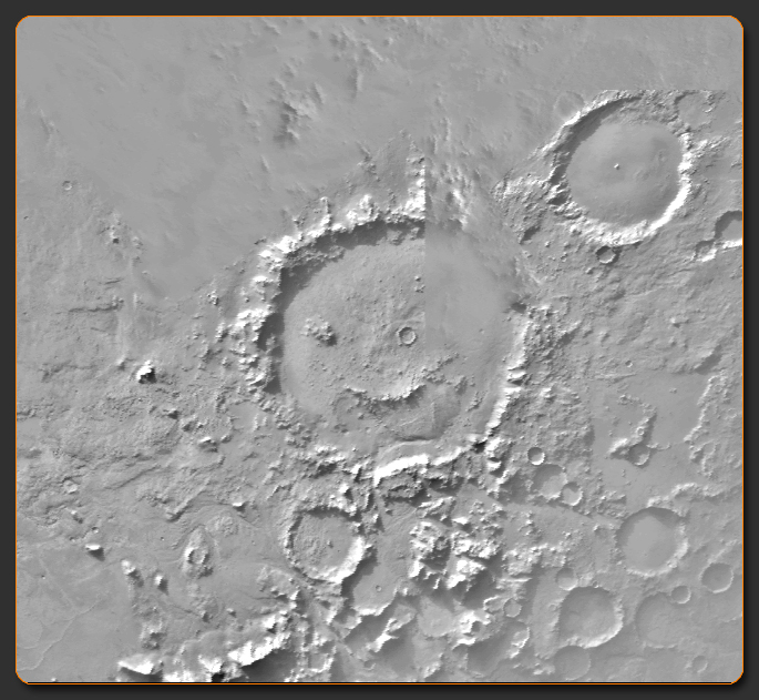

[attach=153778]Mars Crater[/attach]
Image Kevin Hudson used to rough in Mars terrain
