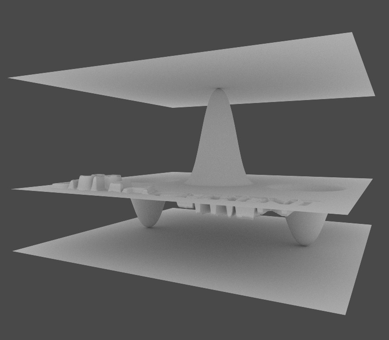

This is my sculpting scene in Zbrush. You can see there have a very popping mesh on the plane.

I’m not sure what the problem is. The image of the displacement map in Nuke will be adjusted so that you can see it - otherwise it would look just grey. The actual values are small because with a 32bit map the range is vast.
