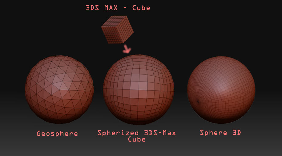

i think the thing you call “pinching” is due to the fact that the sphere3d is a polar-sphere. that means the lines come together on the top and the bottom of the sphere… there are other (better) ways of constructing spheres… i sometimes use 3ds-maxs geosphere… the geometry on that is distributed evenly. i saw other spheres in some peoples posts that have quite a good distribution, the problem with gesopheres is that they dont have quad polygons, just tris…
heres a picture to demonstrate what i mean.
an interesting alternative is the cube. imported from 3dsmax and spherized in zbrush.

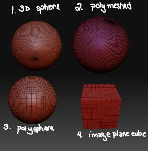

here is what you can get with the aresenal in zbrush besides the Zsphere.
