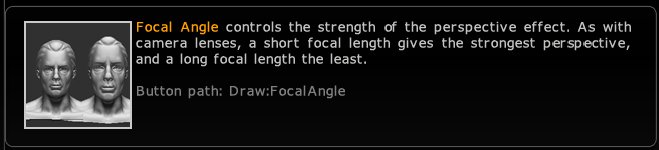

In ZB 3.5 rX the slider is now labeled ā€œFocal Angleā€ which I am guessing means that it sets the viewing cone to the specified value. So, 5 is a very narrow cone and would result in a near orthographic view ( 200mm lens ), while 180 lets you see half a sphere ( 5mm lens ).
What is misleading is that the slider is in the same spot as the last version and the label text is close enough that we could easily gloss over the change. I did. Also the help text would indicate the opposite, it even uses the term ā€œfocal lengthā€.
The slider (on 3.2 at least) behaves exactly opposite from what would be expected in a real world zoom lens. With a real lens, the higher the focal length, the more compressed the foreshortening effect of perspective, the shorter the focal length, the more pronounced the effect of perspective. In ZBrush it works counter to reality. Sounds like they’ve relabeled the slider in 3.5 to make it a little less nonsensical. Too bad they couldn’t have corrected the problem so that we could have some sort of real-world analog.
Datto - I agree it is confusing and that is what led me to search if anyone else was confused as well.
In ZB 3.5 r2 the slider was labeled ā€œFocal Lengthā€, but it was the opposite of what you would expect. In ZB 3.5 r3 it is now labeled ā€œFocal Angleā€ with lower numbers approacing an orthographic view, while larger numbers are a wide angle. Both of the ZB 3.5 versions are opposite of how it behaved in ZB 3.1.
The confusion for me lies in the help text that has not changed from ZB 3.1. Nor has the online documentation.
If you look at the ā€œWhat’s new in ZBrush 3.5ā€ web page, the Perspective page mentions focal length.
The slider no longer sets a focal length, it sets it indirectly.
