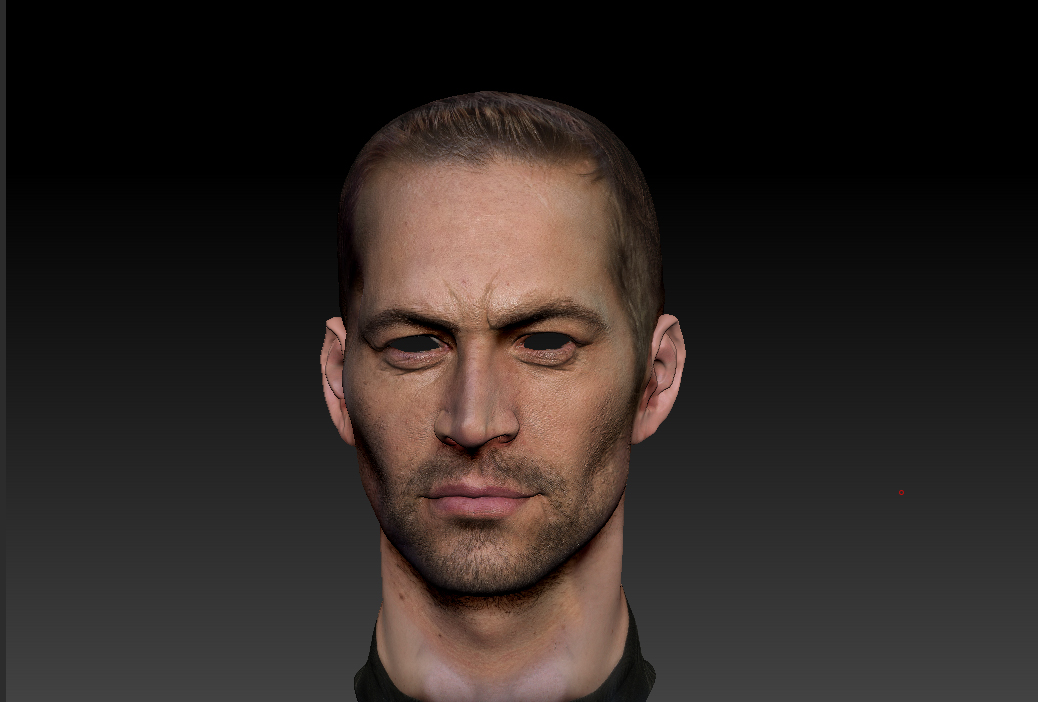

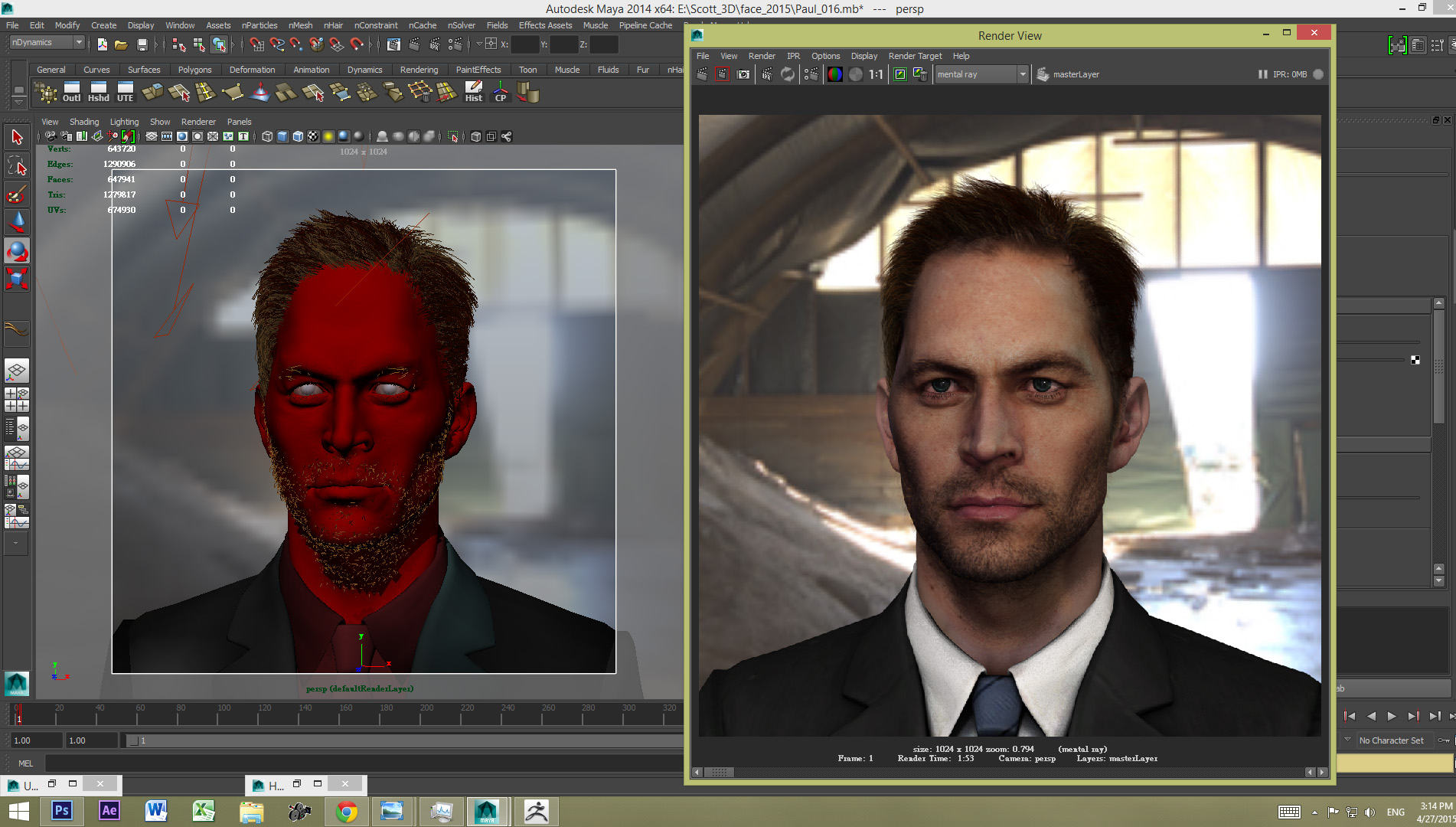

Paul Waker WIP
after watch Fast and Furious 7 , great movie!! , so i want to give this a try, still a WIP
still need alot work on likeness. and this is what i get so far, model in Zbrush, render in maya
thank you for watching

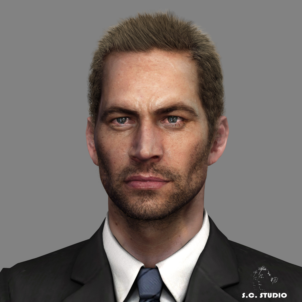

4/27 update
changed face shape and texture. render using mental ray

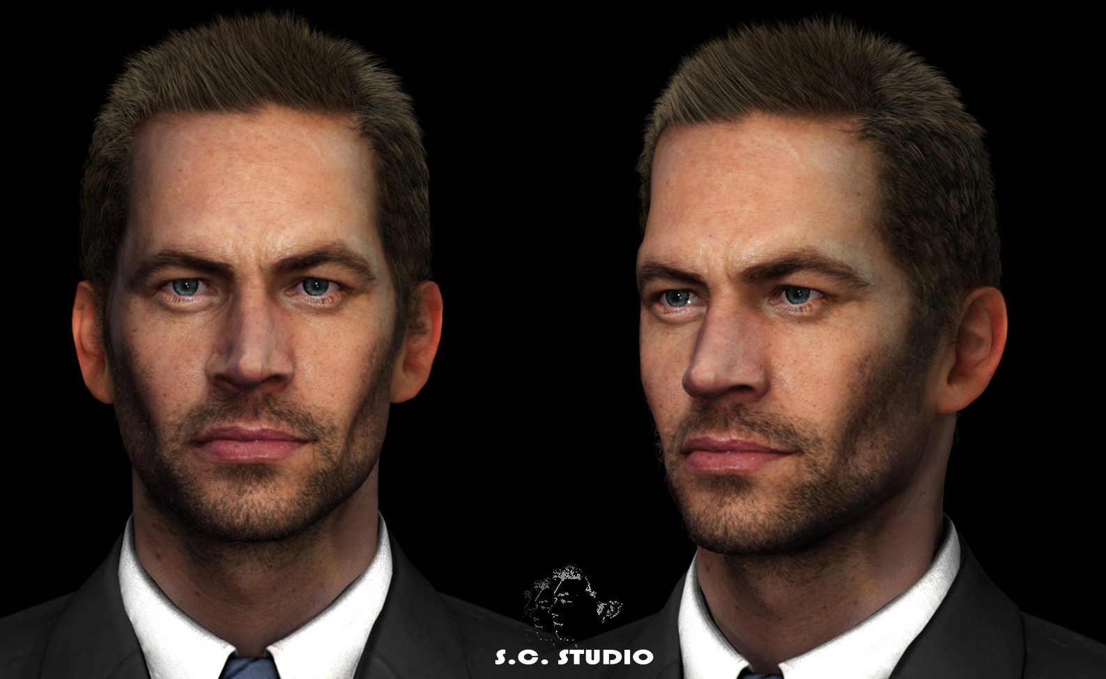

4/28update
4/28 update
working on likeness , still not there yet
C&C are welcome
thank you

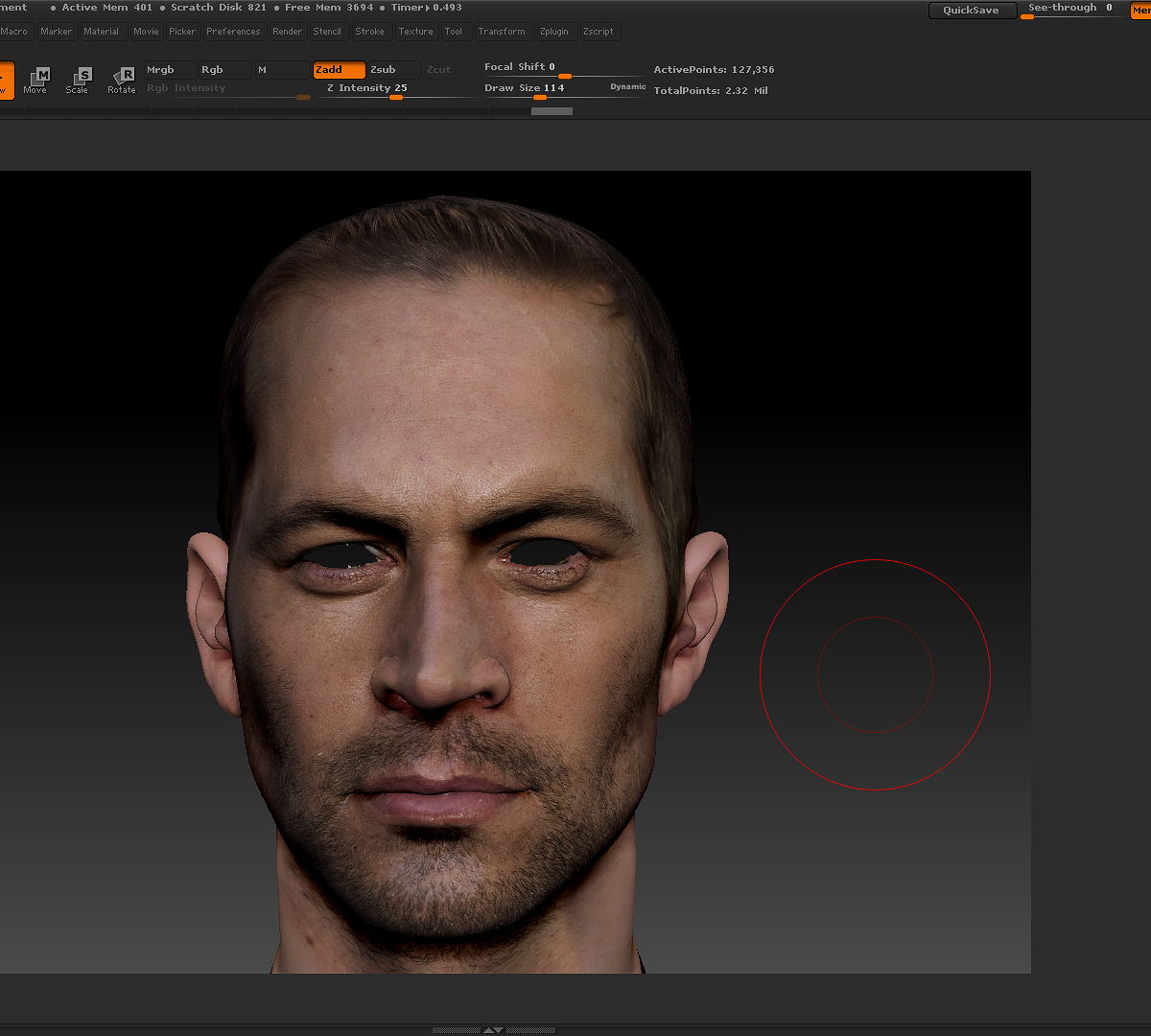

4/29 update
great job.keep up the good work.:wink:
Face geometry…Ok!
Face skin…Ok!
Hair…ok!
What is not OK:
Ears shape, there is like sharp corners. Make it more smooth in term of curves and of course texture of ears is not ok.
Eyes material. Sclera is too red like he cried almost all night long or have been smoked ))) WTF with cornea: too much reflection (?) and as result we cannot see iris texture and pupil.
Intersecting geometry in neck area or just not finished suit?
Keep going, you doing it very well! All hard work is in past just fixing now ))
To HenTyH: thank you, i will work on the eyes and ear, thank you for the comment
To Diablo: thank you for the nice comment

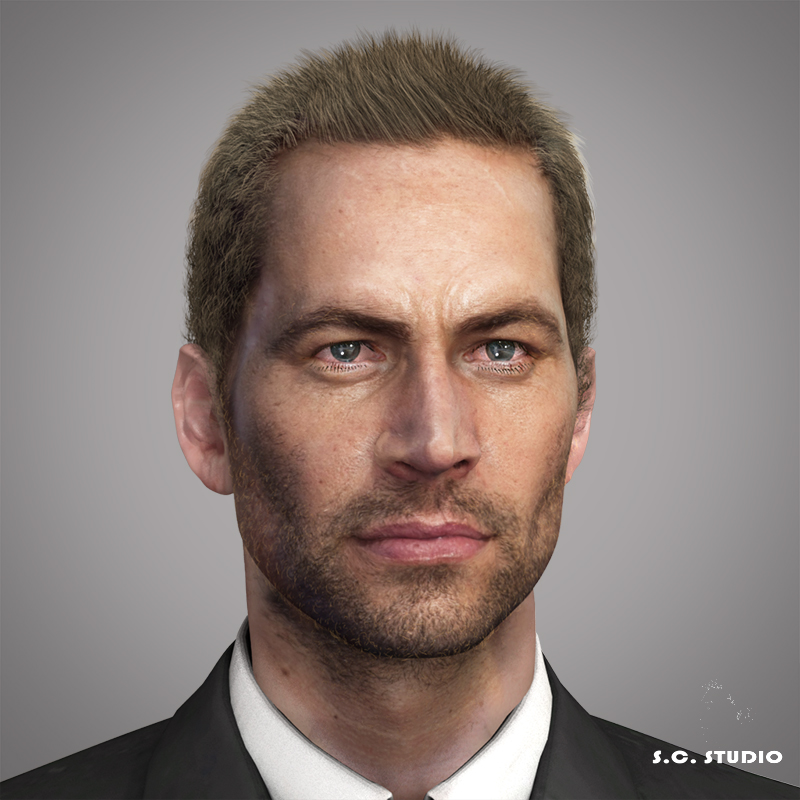

4/30 new update
scottchen23, goooood going, I see changes!
Now I leave some critique from this point (4\30 update): on this render the border between iris and pupil have some kind of blur. About iris texture - Paul have mostly gray eyes with mix of blue-green color and a little bit of orange, just check it on a hi res reference images. You can take gray iris texture and spend some time to do magic in Photoshop )))
On a bottom eyelid of left eye is a gray line (reflection geom.) moved to overlay on sclera.
Now again about ears. Yep, you made tex more natural. But If you have patience and a time, I recommend you to work on its form.
Cyan lines show geometry flow right to ear hole, that is not natural, just look at real Paul ear (right image) and you will see difference.
to HenTyH: thank you for all the advices, its really helpful. did some changes on the ears and eyes
