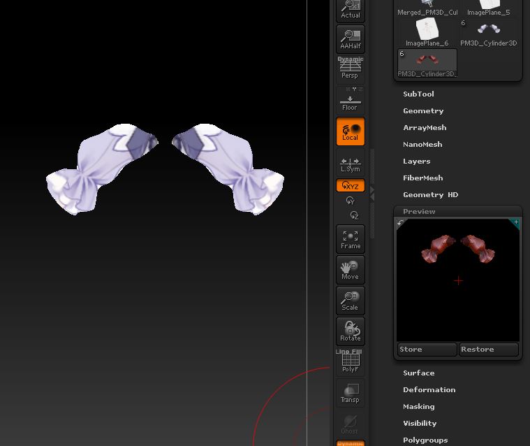

Hi, I’m new to ZBrush, and have a problem with materials.
I painted my model using Spotlight, and also filled it with FlatColor material.
Since then, any material can’t be applied on my model.
However, I noticed that the tool(subtool) preview and “Tool | Preview” show me the model with correct material.
(also, .ztl file is uploaded to http://www.evernote.com/l/ABDLPmYgyqRLmIDXHI0tmFQwPXO_8ytvyBY/ )
Why is my model different between the canvas and the Preview?
Thank you for reading and sorry for my poor English.
This has us stumped at first. Then we figured out what was going wrong.
To fix this, simply select the Polymesh3D Tool and have it in Edit mode on the canvas before you load your model. You’ll find that it now works properly.
The issue appears to only happen if you load the model directly without already having a polymesh selected.
Thank you so much, aurick! The problem was solved!!
I put Polymesh3D in a new project and edited it.
After that I opened my project again.
Then, the model appears with correct material!
