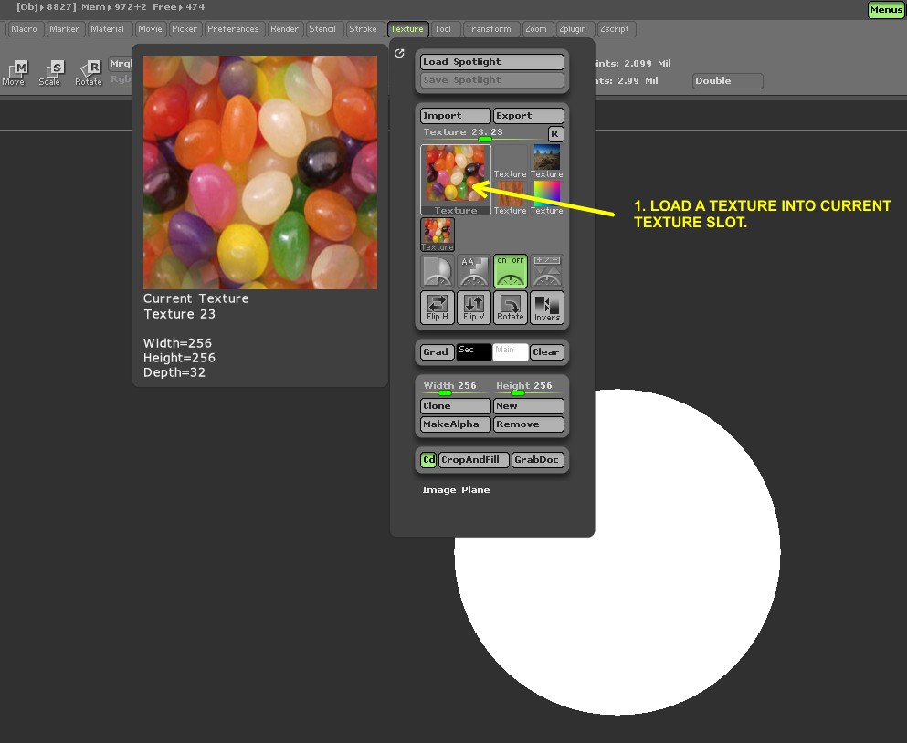

I’ve loaded in my existing texture map for the object, and have two questions:

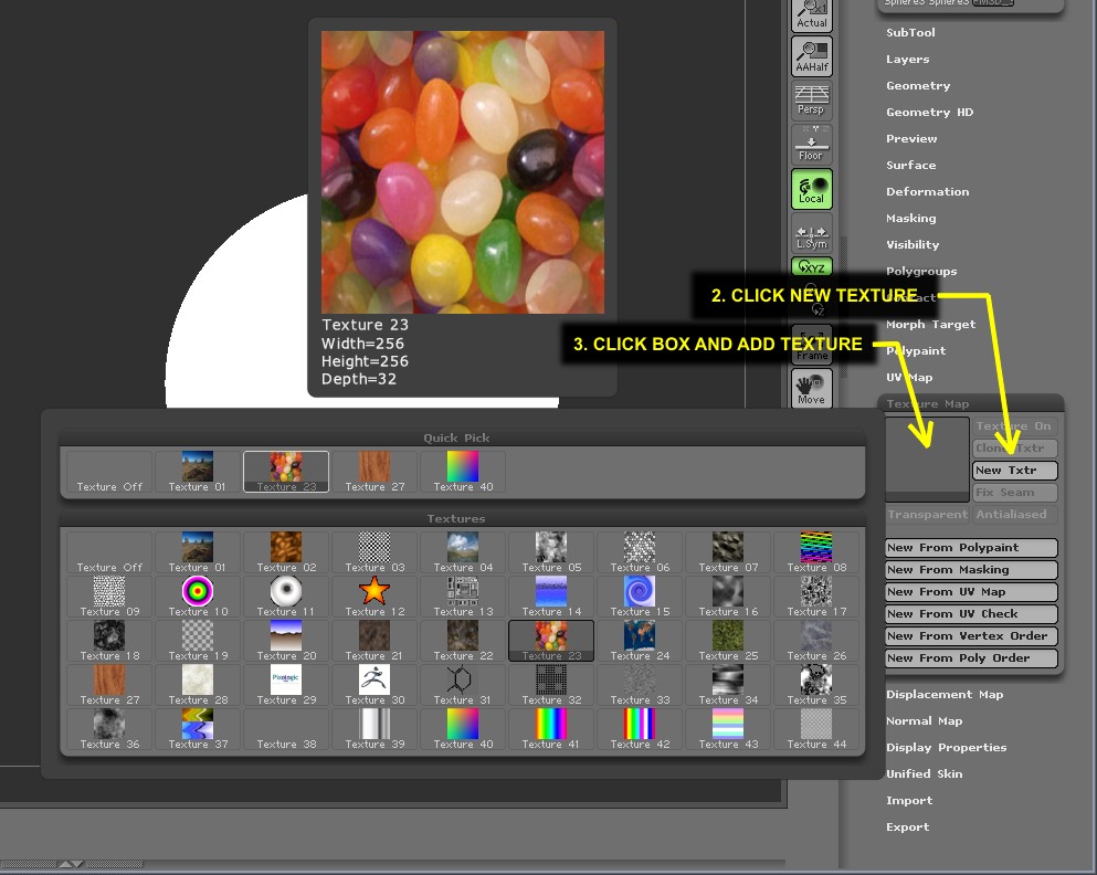

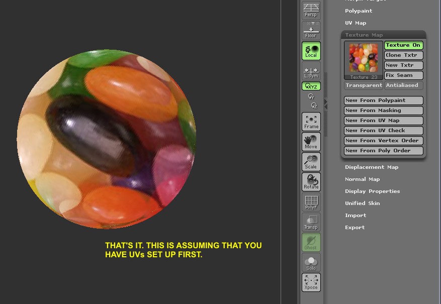

  1. How do I get the loaded texture map to show up on the object? I imported it and chose it under textures, but can find no info on how to get it to show up on the object.

1st problem:
there is no Tool:texture:Txr>clr
There’s a Tool:texture map, but no txr>clr on it
Going to the main texture palette there’s an option ‘clear’ next to ‘main’. Pressing that, it replaced my texture with a white texture. Still my texture is not visible anywhere but in the texture palette.

Yes that works, SO counter-intuitive… but Thanks!
